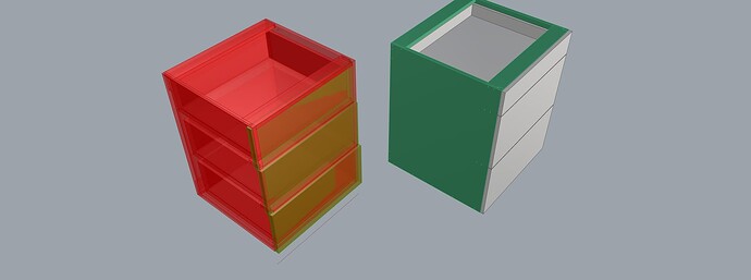

I am having the same problem with a very large grasshopper file for making cabinets. All of the geometry is off. I think I last used the file before the latest update. My co-workers are having the same problem with the file on their computers. Is there an easy way to go back a version to see if the update is causing the problem?

The issues I seem to be having might be related.
Here are some pictures of a few of the issues. Several aspects of the program are off. Breps are not where they should be. Some of the parts are where they should be, others like drawer fronts, drawer boxes and the breps I use to make some of the screw holes are all off.
The photos include a couple of examples of this. I have included a baked cabinet that I made a few weeks ago with the same grasshopper file. I have also tried previous versions of the file with the same results.
I think it just might be my lack of experience with making good grasshopper programs. The update seem to reorder some of my list items which is throwing off my build. I guess I just need to trouble shoot all the list items to get things back to where they should be.
I have also experienced that the update has reordered my lists!!!

My program is also somewhat large, and I’d rather not post the whole thing. Here is a screenshot of two examples of components that changed their order after the update. The Breps being deconstructed are just rectangular boxes shown in image 2. The edges I need are in image three. The edge circled in black also changed direction and I had to switch the start and the end points (in bottom red circle image 1). I know that the order of the edges can change, but with all the inputs for this program, they have never changed their order until the update. I would love a suggestion on how to create a rule that would force an order and keep the edges going in the same direction. I use more or less the same group of components a couple dozen times to create drill holes in the cabinet side for several different types of cabinets. So there are many list items inputs I have to find and fix when the order changes.
