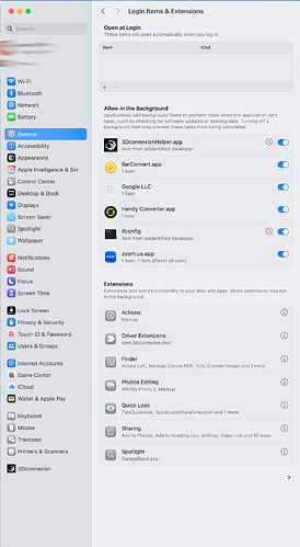

I just updated my Rhino with today’s update, restart and I am still missing file previews in my folders? Please help. I’ve been patient thinking the next update will solve this issue? This is impacting my professional workflow since I number files as I design. Thank you

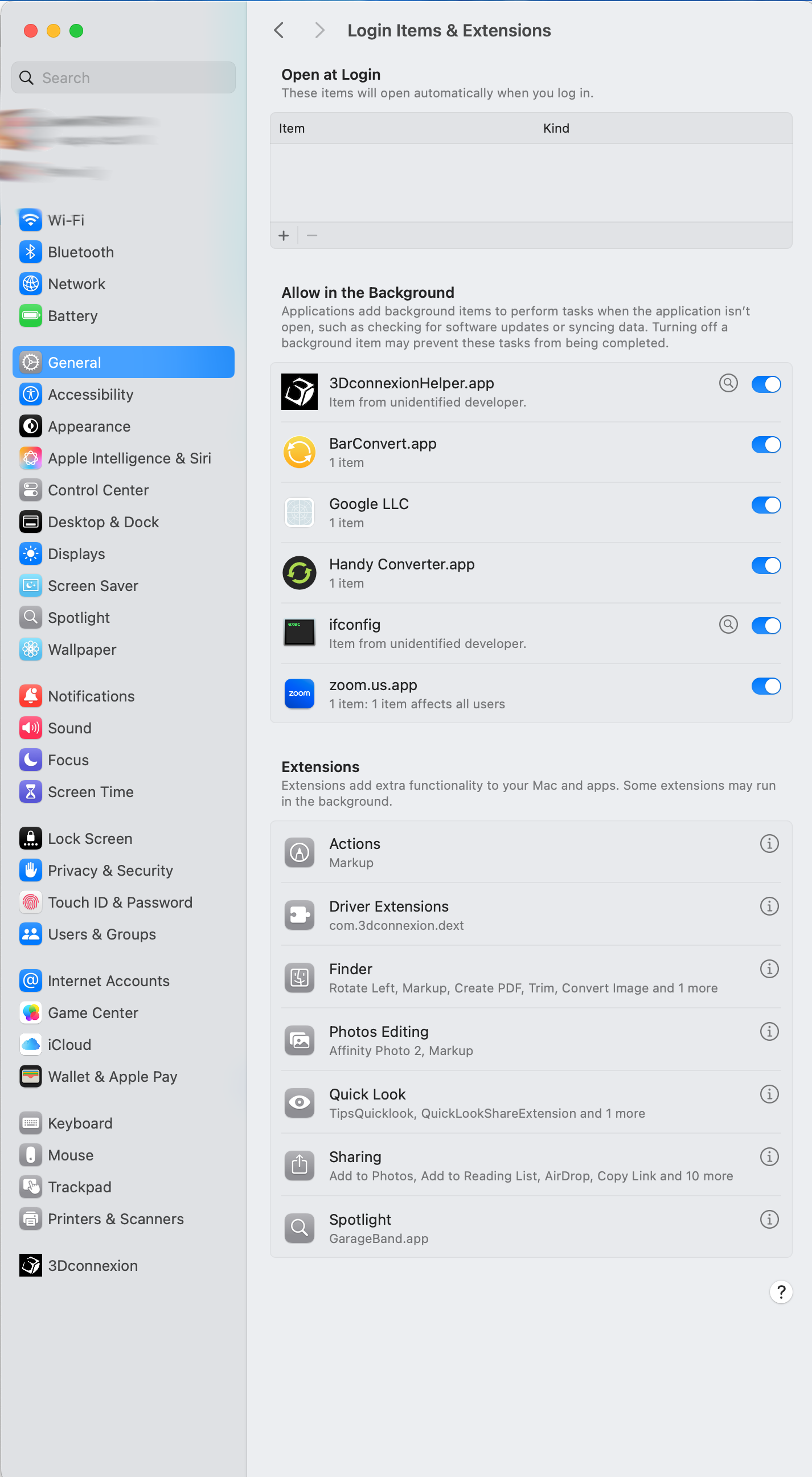

I don’t have this issue with any other software other than Rhino? Could this relate to Apple Quicklook? Which after installing Sequoia, I noticed Affinity Apps asked for my approval in order to view files. This was new to me.
Shown here under System Settings - General - Login Items and Extensions - Quick Look

This is related to Quicklook, yes.

Some users have issues with the older QuickLook Generator plugins no longer working on Sequoia. QuickLook Generators were compatible with Mojave and earlier.
Unfortunately, if you have this issue, you will continue to see generic icons rather than Thumbnails.
