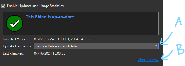

Make sure you have SRC selected in the Update Frequency of your Help>Check For Updates.
If nothing is available you can click “Check Now…” and sometimes a more recent release is available than what is shown in Rhino.
No, there must be more to it than that. 8.6 is the only thing available to me.
OUTRAGEOUS :bangbang:
OK, wait… I stumbled across 8.7 waiting to be installed. Working on it
FINALLY. :rofl: Way harder than it should be.
