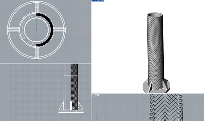

Im looking for a way to insert points in every intersection of this mesh.
Does anyone know if this is possible?

Hi and welcome, Jonathan -
When you only post an image, it generally means that we need to do quite a bit of guessing when trying to help. In this case, is there really a mesh or are you using that word in a more general meaning? If there is a mesh, the ExtractPt
will provide you with the points that you are after.
Select all the curves and use INTERSECT? Upload a file - can’t work from pictures.
Part Specimen Laser Texturing’.3dm (372.9 KB)

Thanks for the warm welcome. Im sorry for the inconvenience - the file is uploaded here. Im very new to rhino but the end goal is have a parametric hexagon grid of points warped onto the surface. Im not sure if this is possible?
