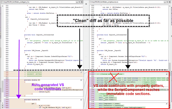

Some screenshots about using a DIFF tool on the resulting code:
To begin, the first similar code lines is the code in the main method of the ScriptComponent
Fig.1. Similar code (white clean DIFFs) starting from VS row 138 / GH row 70
This diff (Fig.1) shows that the code generator added some code in the VS version before the ScriptSource code was inserted into the SolveInstance method “as is”. It also added a lot of additional code before that, but only such VS code which is not useful for merging back to the ScriptComponent (if modifying the code in VS and sync is desired).
Thus, showing a diff of the code from the top of the files is entirely meaningless. Everything of interest starts on line 138/70.
Fig.2. Next diff screenshot shows the end of the “main method” area (marked red). Some code original was inserted but commented out by Codegen (since it lacks access to type info for the outputs), and below the end “}”, and the code generator also inserts some new code before the “Custom additional code” (see the left VS side)
And finally (Fig.3.) some code, like properties versions of the Input Params etc, is inserted also after the < Custom Additional code >.
Fig.3. VS code continues where the script is ending with some extra added convenience features, like autogenerated properties etc.
In short: The aim has been to generate as much “white” (clean) DIFFs as possible making it simpler to maintain two-way code sync between VS and the ScriptComponent.
