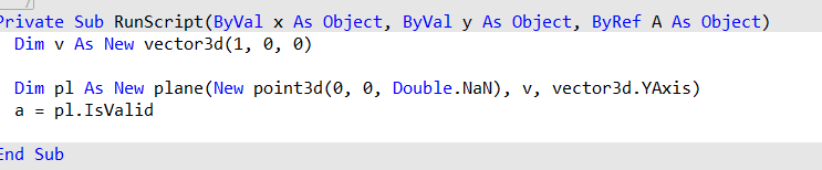

Plane.IsValid bug?
This function returns True, not sure that’s the result it should be.
Hi @MateuszZwierzycki ,
why do you think that this Plane should not be valid? You have the origin point and X and Y vectors. Do you think that Double.NaN should “break” this and return false?
Hi @MateuszZwierzycki,
Why is this important? Are you seeing planes with origin component as NaN?
– Dale
It seems the IsValid function is inconsistent, unless I’m missing something - setting one coordinate of the X or Y axis to NaN returns false, while the NaN origin is fine.
We’re performing unit tests, where I want to make sure the method throws an exception. Using the IsValid function as one of the gatekeeping conditions.
RH-76196 is fixed in the latest WIP
