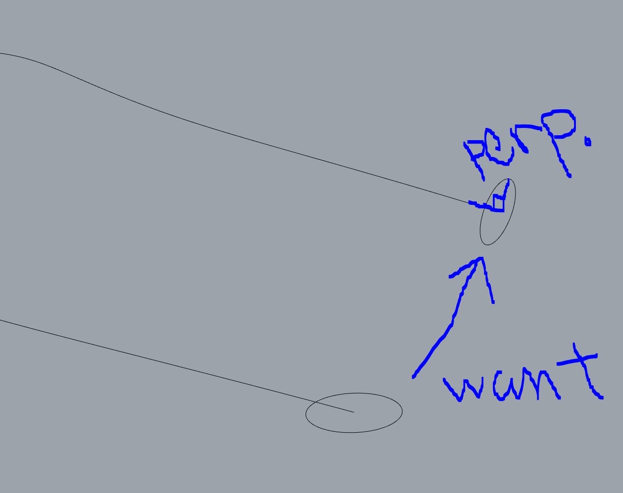

Just would like to place a curve, say a closed circle to a another curve.
I’m sure I know, but just couldn’t search the right command…
Orient?
Move?
OrientonCrv?
Very simple task…
Orient?
Move?
OrientonCrv?
OrientOnCrv with the Perpendicular option.
Alternative for circle perpendicular to a curve is Circle with the AroundCurve option.
Thank you @davidcockey!
