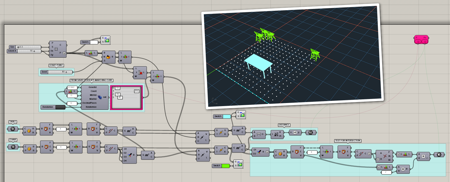

If you want to place object A and than B,C,D,E at once as far as possible from A you could maybe use an optimization.
Here you can choose random one point on the grid, and than the optimization will place the others as far as possible from the initial object. You can do it with Galapagos for exmaple.
I used David Stasiuk’s gene pool editor, so you don’t have to manually edit the gene pool.
I made a boolean which tests, if the objects are intersecting with each other. With Octopus, you can insert a boolean as fitness, so you just get result with no intersection.
You could also use “Delaunay Edges” on all object centers and use the “Curve length” to find the solution where also B,C,D,E have the biggest distance to each other.
If you want to repeat the step, add the placed objects of the first step to the “merge component” before testing for intersection in the second step and so on.
Maybe this helps you.
place object with optimization.gh (328.3 KB)
Wow, thank you very much @tim.stark ! :grinning: It really does help me a lot! I will install the Octopus in order to make the boolean as fitness. A question, I would have… if I add more groups of furniture can I roll them in the same time with this optimization or should I do separetely for each group?

It’s possible to do it in one optimization, but it’s easier for you, if you do it in more steps. Just add the objects from the steps before to the merge component to test if they intersect.
The only thing to mention is, that Octopus needs a true boolean when you want to open it. If it’s wrong you have two possibilities:
  1. change the gene pool manually so that they don’t intersect
  2. invert the boolean, open ocopus, and delete invert
Thank you very much! :grin::grin:
You can use also Galapagos for the optimization. With Stream Gate, the solution is empty if the curves are intersecting.
