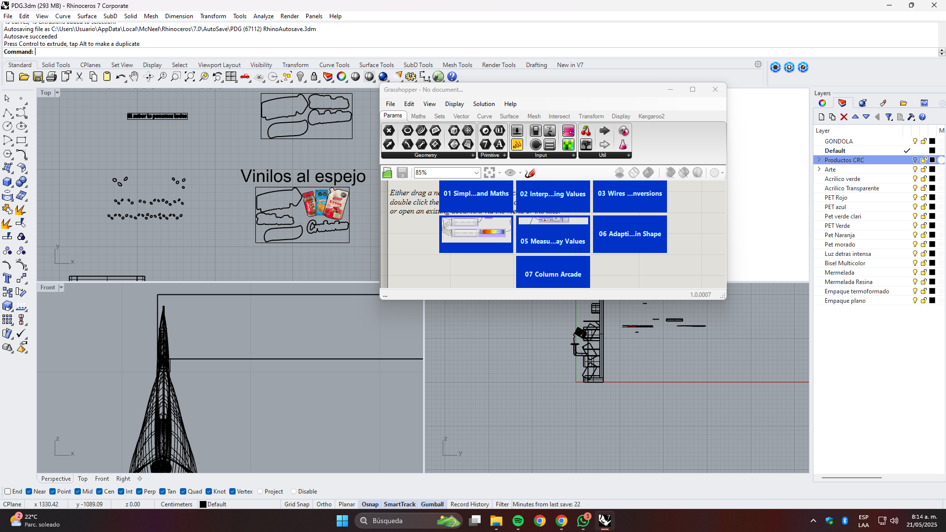

I don’t think the screen shot you use helps answering your question. It just show that you have a pirated :pirate_flag: version of Rhinoceros !

What I need is for all the objects to be arranged in such a way that there is 1cm of space between each of them
Nesting program can do that. Use OpenNest you can specify the distance.
