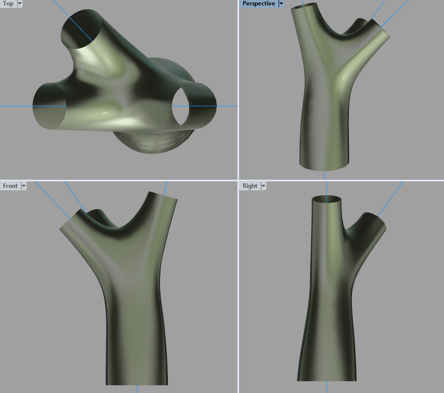

Hi Guy,
Anyone have Idea to make this surface in Rhino or grasshopper?
Please add your advise to me
Thank so much
Hello sailor!
This will help you get started.
weird_branch.gh (12.0 KB)

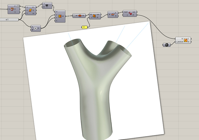

If you can use meshes:

The old fattener component I shared in the post Dani linked above won’t work here, but the new one I’m working on does:
branches.3dm (221.8 KB)
This is only for the Rhino v7 WIP version though.

The best I can do, for sure SubD could change a lot of things !!!
The genepools are used to input the radius of struts.
AdaptorClearance mut be done for each strut but here it applies for all struts of the node. Not perfect for what you want.
20200413_YANG_to_send.gh (45.1 KB)
I think one advantage of my script is that it output construction geometries. So you can use them to build your own geometry by hand.
Yes it could be converted to SubD in RhinoWip,
perhaps an approach of this style.
PIPE_Y.gh (1.5 MB)

Just a try
joint.gh (12.6 KB)

I tried briefly, but my skills just aren’t there yet. But I was thinking to possibly achieve your desired results using the Dendro components somewhat as in the model here.
Gnon does the homework
look at the example of @anon39580149
NGon | Food4Rhino
unnamed.gh (9.6 KB)
Here a solution using Mesh and Dendro. It allows to output a 3d model with thickness. Not very clean.
Like @vikthor it uses blend.
20200415_nodes_test.gh (31.8 KB)
