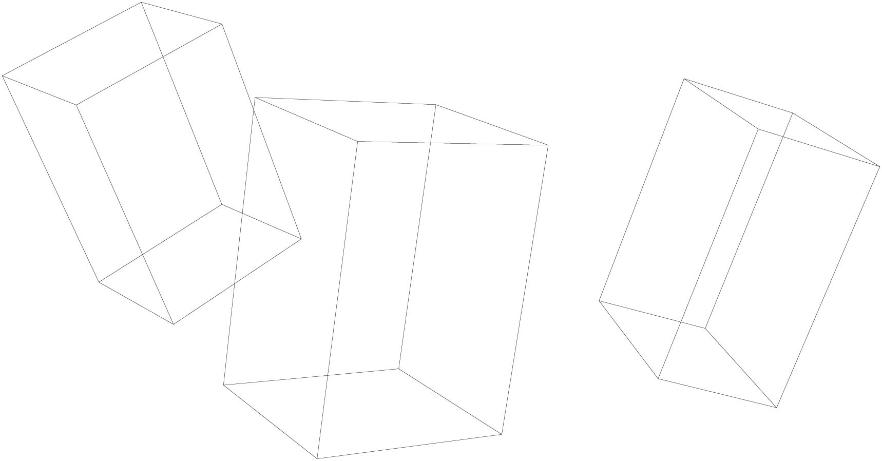

i sometimes need to extrude multiple curves or surfaces whose normals aren’t always facing the same direction… if i do any single extrusion (ExtrudeCrv or ExtrudeSrf) , the results are as i want them to be… however, if i select more than one curve or surface, all extrusions occur in one direction depending on the first item selected… in those instances, i’d like to be able to select multiple curves/surfaces at once and they extrude in the direction as if the commands were being run on them individually.
strangely, the preview of the MoveFace command (with normal constraint) does do what i’m asking but upon running the command, the behavior reverts to a single direction.

also, regarding the MoveFace glitch(?) i mentioned… i guess that example only works when the faces arent connected… if you do something like this example, you’ll be able to see what i’m talking about.
so the preview show like that but once you return , they all move in one direction.

The tricky part here is figuring out which direction is “up” for each of the curves. Each curve has a natural up direction that is defined by the direction of the curve (run the Dir command to see that direction). If you simply want Rhino to extrude “up” relative to the curve direction, this is straight forward to script. However, it is incredibly simple to draw two curves that are in the same plane but have “up” pointing in two directions. For an example, draw a curve using the Curve command - one picking points clockwise, the other counter clockwise.
Now, take a whole bunch of curves and randomly scatter them in different orientations around your screen, and without looking at the direction of each curve try to predict which direction it will extrude. Unfortunately, you may wish they’d all extrude in the “obvious” direction, but no such obvious direction actually exists.
In your example with rectangles below, it is possible that one of them is actually oriented backwards, and the resulting correct extrusion would be opposite the red arrow you drew.
This is why Rhino chooses a single direction when you select multiple curves or surfaces to extrude - doing anything else is usually wrong, unless you’re very strict about making sure all the curses are oriented properly. We try to make it so that you don’t have to care about curve orientation in Rhino - and this behavior is a side effect of that.

right, i see that… when it comes to extruding them though, they still both go in a positive Z direction (or x or y direction if they’re 90º to the plane)… i.e.- they extrude in a predictable direction regardless of their Dir…
still, i don’t think i’m getting my point across… lets say i have two circles drawn-- one is flat on the cplane and the other is at 90º to the cplane…
if i select the flat one and ExtrudeCrv, it will extrude in the z direction… if i select the vertical circle and extrude it, it will extrude in a direction parallel to the cplane…
but, if i select both circles at once and ExtrudeCrv, only one of them will actually extrude… the other circle will preview as if it’s sliding along it’s plane but will not form any new geometry upon running the command…
and i can’t for the life of me think of any user’s scenario where this would actually be desirable… as far as i can gather, user’s in this scenario would expect one circle to extrude vertically and one to extrude sideways… i think they would expect all selected curves to extrude in the same direction as they would if ExtrudeCrv were run on them individually… it should default to that then, if they want the behavior as it is now, they’d use the direction option in the command.
again, the obvious direction (to me at least) is the same direction as they would extrude if using ExtrudeCrv individually… it makes much more sense than having randomly scattered curves which all must extrude in one single direction… because the direction that’s ‘right’ for the first one selected is almost guaranteed to be wrong for all the other curves in the selection… (but again, if the user does in fact want all extrusions to go in the same direction, the command(s) are already designed to handle it via the ‘direction’ option…

In your example with rectangles below, it is possible that one of them is actually oriented backwards, and the resulting correct extrusion would be opposite the red arrow you drew.[/quote]
that example is with the MoveFace command but yeah, that’s how it should work… the option used was ‘normal’ so i’d expect them to move in the normal direction… even if one were flipped
but that example was maybe meant more as me pointing out a possible bug… the preview shows one thing but the resulting geometry is completely different. (but i do feel in the case of MoveFace, if you select multiple faces, they should all be treated as if they were selected individually… and should only move in one direction if the user opts to chose a single direction… same goes for ExtrudeSrf )
but rhino doesn’t always choose a single direction… if i have a planar curve, it will extrude perpendicularly to it’s plane… regardless of where the cplane is at… this is what i feel is the proper way to do it… this is the way ExtrudeCrv (and Srf) works when running the command on a single curve and it’s how (again, a guess) everyone would expect it to work…
however, throw 2+ curves into the mix and it completely ignores that logic and extrudes everything in one single direction depending on the orientation of the first picked curve…
you’re explanation isn’t too clear for me because the info is conflicting… if a curve extrudes ‘properly’ when using a single curve in the selection then that’s the way it should extrude in a multiple selection… right?

The geometry isn’t created when the extrusion direction is parallel to the plane of the curve because the object isn’t valid. The extrude command perhaps could be smarter about knowing that the object will not be valid and refuse to preview for you - but that still doesn’t help you get what you actually want.
I realize it looks like it’s obvious to humans. But you’re likely to get the opposite direction as frequently as you get the correct direction, because to a computer, there isn’t such a thing as “obvious”.
It is easy to make all of the planar curves in the scene extrude perpendicular to the plane that they lay in. The difficult part is getting them all to extrude in the “right” direction. In the image you sent with the ribs, there’s nothing that indicates to Rhino which way is “up” for each curve - unless you’ve managed to orient each one properly before extruding the curve.
My guess is that if I were to write a script for you to extrude all these curves, some of them would end up extruding to the left instead of the right.
Perhaps for this kind of geometry you’d be best off doing the work in Grasshopper anyway, but that’s digressing a lot from your original question.

example: using the bottom half of the rendering i posted above (with extrusion distance exaggerated for clarity)
that’s what happens if i select the curves then ExtrudeCrv.. up/down is wholly irrelevant at this stage because only one of those has actually extruded in the right direction.. (and which one, i don’t even know).. it’s just completely unusable results.. but what frustrates (and hey, i’m not actually frustrated here, you know?.. just nerding out some).. but what frustrates me even more is that if i actually wanted those results, i could have them easily by using the ‘direction’ option.. ie- i’m not asking to change the way the command works -or- other users aren’t going to be bummed because the command already includes ways to give these results via the direction option.. it’s almost as if having the direction option is redundant in the commands..
all i’m asking is for a little consistency between the way ExtrudeSrf and ExtrudeCrv (and even MoveFace) works..
if i select one curve and extrude it 10 units, i (and i think everyone else) would expect it to do the same exact thing as when i select 2 curves and extrude 10 units..
because as it is now, i can select curveA, extrude 10 units and end up with one thing but, if i select a non-planar curve then curveA and extrude it, the extrusion goes in the Z direction regardless of which plane curveA is on ??
this, to me, makes zero sense.. it should do the same exact thing as if i selected the curve by itself.. and follow the same exact rules rhino has in place regarding up&down..

Ok, I get you. It sounds like we already have better rules in Rhino for choosing the up direction than I thought. I’ve added this bug as http://mcneel.myjetbrains.com/youtrack/issue/RH-20132 (our bugs are not publicly visible yet, but we plan for them to be soon)
This will not get done until V6 at the earliest.
