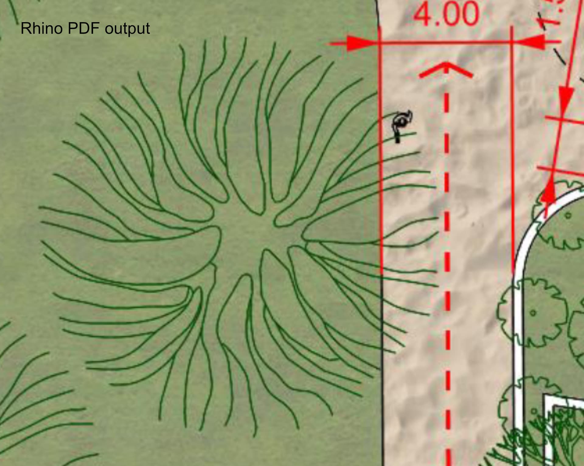

Yes, I compared the Rhino 8 pdf output with the one created with Acrobat Pro.
The last one is much better if is it’s set to high, I think I’m gonna use Acrobat Pro. It is much slower than the native Rhino pdf engine but I can tweak the quality…I can set it also to raw.

the raster PDF created with Acrobat Pro generated a file of 8.8MB. It was set at high resolution at 300dpi.
The Rhino pdf output is 3.2MB set at 300dpi
Within the Rhino pdf engine you don’t have access to the jpg quality, we can only tweak the dpi resolution.
Zooming in the Rhino pdf raster output you can see the jpg artefacts.
Please watch the two crops:
@gabrielefx would it be possible to send me the 3dm file you are using for this so I can try and repeat this?
i think @gabrielefx suggests you cannot set the compression level because it is fixed to some middle value between heavy and no compression. if there is a hardcoded value of compression in rhino then it is easy to make it adjustable. if it is hardcored without internal variable which affects compression then it is not that easy.
These are things I can figure out if I have a sample 3dm. There are decisions made on things like compression or png versus jpg when creating a PDF with Rhino PDF. I need to see what is happening in this specific case before making any assumed response.
