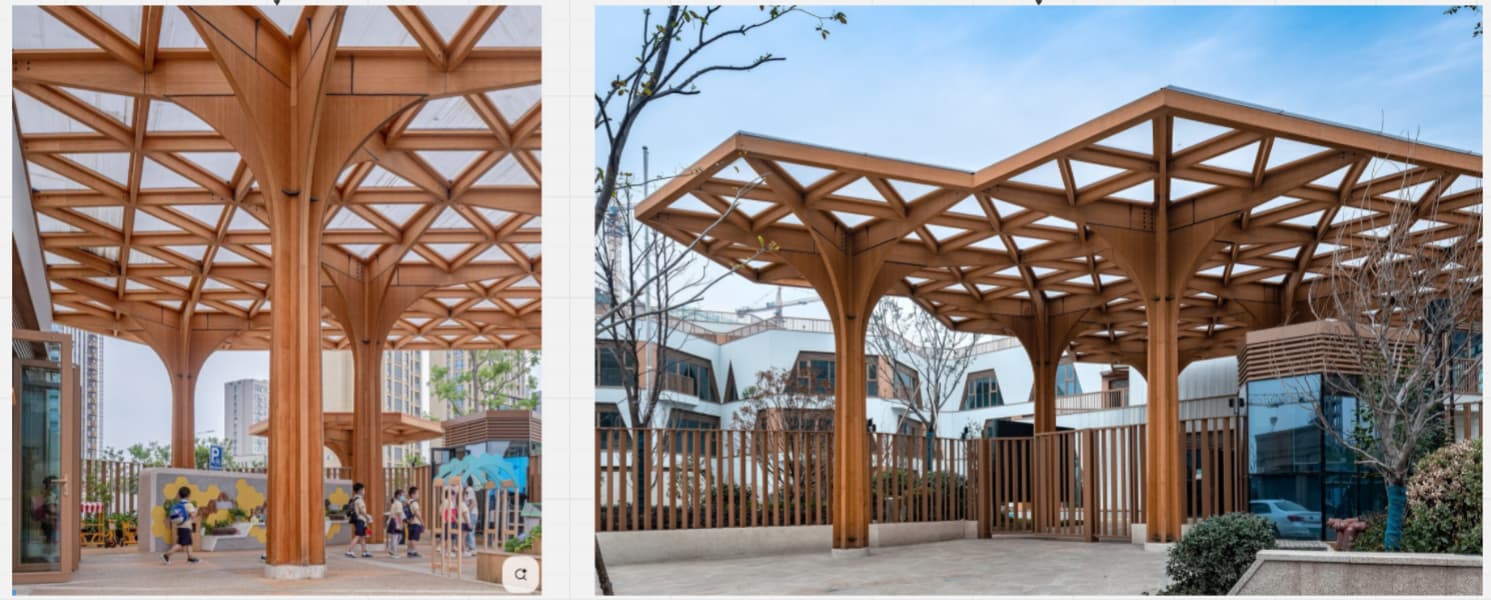

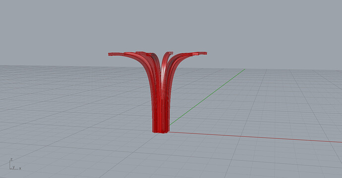

Hi, I am new at grasshopper and i’m trying to replicate these columns in a college project, but I’m not getting the same result, just something similar.
Could someone help me where I’m going wrong?
Here is the script attached.
Reference:

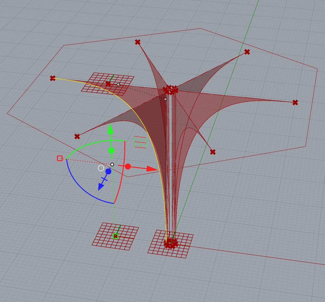

I’d draw a single curve in Rhino and use that to generate your geometry, it’ll be more interactive too. I created something that should get you over this hurdle :slight_smile:
columns teste v2.gh (20.0 KB)
It worked, thank you so much!!
