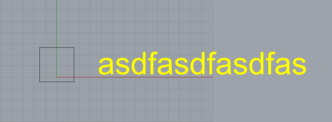

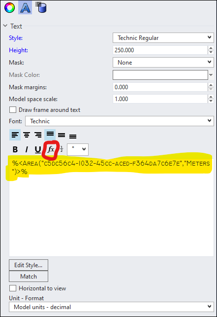

Just a small annoyance when copying existing text items to be modified.
  1. Create a text item.
  2. Delete the text from the panel. (highlighted yellow)
  3. Click the field button. (circled in red)
  4. The deleted text reappears.
Before deletion
After pressing fx button and assigning new text field.
If you test it you will see the deleted text actually reappears upon button press.
cheers,
Nick

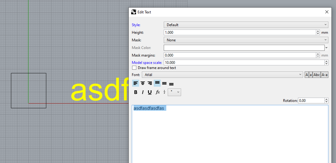

  1. A simple rectangle and some simple text.
  2. Double click text

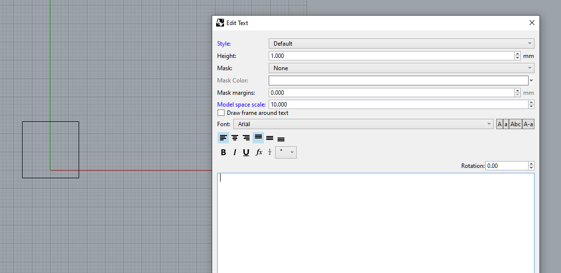

  3. Delete the existing text from the text box. Note it is gone from the text box and the viewport.

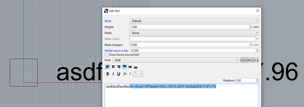

  4. Press fx button. Note the text in the viewport is displayed again.
  5. Go through the field process, in this case getting an area of the rectangle. Note the original (deleted text) is displayed again, and the field is concatenated onto the end.
This happens in both the Edit Text dialogue and the text Properties panel.
I just noticed another aspect to this. The deleted text reappears if focus is lost from either the Edit Text dialogue or the Properties panel. So I suspect this may be some failsafe to avoid zero value text.
