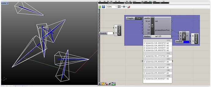

Found 5 minutes for a test C# (and some random pyramids) using the conn Trees mentioned above. Spot the obvious: if the Pyramid is a tetrahedron (i.e. 4 Faces) … there’s no way to tell what is the top/bottom pair (unless there’s rules for the base Face) so all combos are picked.
Wow ! This is very different from what I was looking for and a bit more complicated. However it is an interesting concept and has lead me to explore something more. I love this community. It helps so much toward learning and investigating the potential of grasshopper. Thank You!
For this particular case you may mean the potential of coding (less than 5 minutes job).
