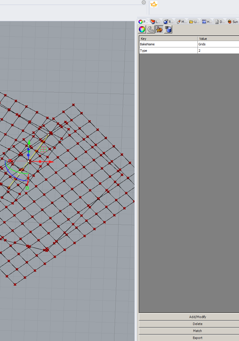

@ForestOwl What’s the problem?
It cuts where it not has to cut. The separate grids cuts each other somehow.
Thank you. Sorry, my posts are a little bit confusing. Uhmm, what I tried to achieve is to make more than two grids.
Is this script meant to work for that?
Yep. It shouldn’t cut in other planes.
Okay. Hmm, it cuts in other ‘grids/planes.’
I don’t know what I am doing wrong.
Yup, all dependent on attribute filtering to create branches/relationships.
Context of the entire workflow is preferred, to avoid confusion and redundancy.
You will notice a error. There are two grid linear lines that should be in the Boundary. Use the elefront match properties on those to match their respective attributes.
The Elefront process allows for manual editing on occasion :slight_smile:
Preferably that attribute would be assigned earlier in the process, avoiding the dispatch.
Can you show an image of what shows that? The planes are very close together, so a top view is not so easy to spot problems.
Now that I think of it, check your units in rhino (units command), and the absolute tolerance to something like 1/1000th of the smallest curve your have. I was using a absolute tolerance of 0.001 for this solution.
