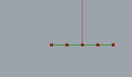

I have one curve then I divide it by number to have some points. And I have one other curve
How I can offset the second curve to these points

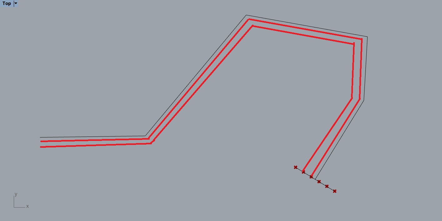

Please see my file
Offset curve to point list.gh (6.4 KB)
Offset curve to point list.3dm (29.9 KB)
Thank you so much
I asked for precisions also… Are you trying to get the points of the tiny curve onto the big curve at the same proportion distances? I think I don’t understand your question

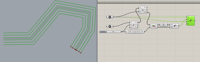

Offset curve to point list_RE.gh (9.4 KB)
Hi Jakinta
It so good solution, but maybe not same my target.

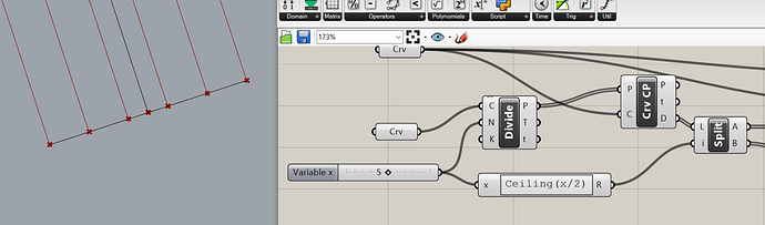

I check with number of divide is 2,4,6 is ok ( equal by divide point ) but with 3,5 is not good
That is exactly why Ceiling expression is there for. To deal with odd numbers. According to me and to your problem description above solution is good.
