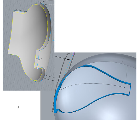

Offset a curve on a compound curve surface is there a command?
V5
what command exists to offset a curve on a surface.
update…found it…OffsetCrvOnSrf !
OffsetSrf isnt of use.
Offset goes nuts on this attached file.
Need the border duplicated inwards 0.35inch.
Ideally hugging the surface, to then place a surface between the two., by using both curves to trim a cloned dome surface I reckon ! or is there another way to surface between the curves ?
Flaps V5 3D petals flowAlongCurve.3dm (2.6 MB)
Steve
A way to achieve an accurate offset:
Copy the domed surface in-place and work on the copy.
Split the copy with the petal outline - rotate the dome first to move the surface seam, otherwise you’ll have 2 split surfaces.
Offset the resulting petal as required, (Solid=no)
Duplicate the border the offset petal - this is your offset curve
Loft between the new curve and the curve on the split surface - OR choose Solid=Yes at the offset stage and delete unwanted parts

I didnt realise rotating the dome to align seam was necessary,
I had done the offset curve on srf, cloned the dome, used the outer curve and and inner curve and trim leaving me with a .35 wide surface.
then used the inner curve and trim another dome clone and obtained the inner canvas area.
Then I did OffsetSrf solid=yes 0.1 outer beading, and 0.03 canvas area offsetting inwards (dome being outer extent, but then thought what the heck whats 0.015 beyond the limit and offset b=both instead !
Is there a hidden nasty in my method ? I guess I need to redo due that dome seam.

You can use SrfSeam to move the seam without rotating the object.
