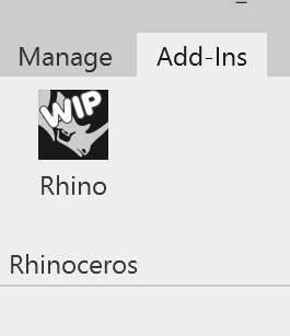

When loading Rhino Inside via the Add-Ins tab of Revit 2019 and there are no licenses available on my Zoo server, it crashes Revit.
After I click ok on the last popup (“Rhino will now exit” dialog box) it closes my Revit session without prompting to save my work. When there are licenses available it works just fine. Any ideas other than trying to open Rhino separately first to ensure a license is available?
This is a known issue that we will have to look at. It is actually by design, but now that we run inside other platforms, we will need to see if there is a more elegant way to exit.
Thanks, I’ve logged this bug:
https://mcneel.myjetbrains.com/youtrack/issue/RH-55790
RH-55790 is fixed in the latest WIP
