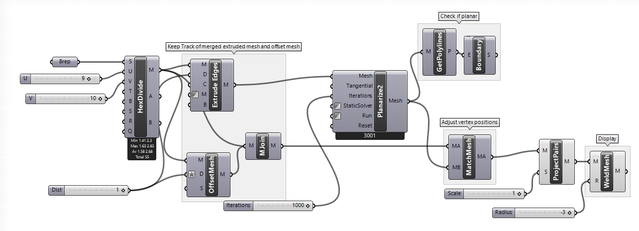

This is what I have now (also attached Examples_MeshLibrary180824_workflow.gh (15.6 KB)):
Thanks again!
Because projection is just additional step, planarization of sides guarantees planarity.
So it depends how well you can planarize you geometry.
And then you take edges lines and cut it with plane. That cut points you connect as a polyline which is flat because it sits on the plane. And how you define that plane so that you have better connection surface at sides it depends on either straight forward averaging of points or optimization methods by averaging plane to adjacent planes.

ah, i finally understand it now…when you said projection i didn’t realize it was projecting onto each individual plane ALONG the vector derived from the planarized edge planes (I thought it was a simple projection along the normal of the average plane itself). Thanks again for the help and the file! Any thoughts on how to keep the boundary (or at least the two edges that supposedly touch the ground in the example here) not jagged? I guess the simplest way would be to just trim everything with a plane…
Yes so far I seen examples either they make foundation to make the foot fit or planarized elements are cut. In coding it can be done more clean, but basically the same concept.
