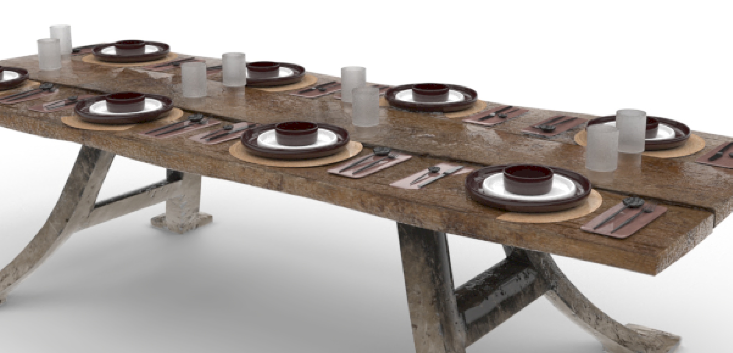

Hey all, (@nathanletwory maybe?)
I’m on a job right now, and it’s crunch time (like a cple hours
) and I’m getting what looks like low-resolution image zoom way in.
Is this with Rhino Render or with Raytraced?
Raytraced, thx for the super quick response! I am probably going to have to go to Twinmotion after anyway at this point, but if theres a chance i can stay in Rhino, it would be grt. Thx
Tools > Options > Rhino Render > Viewport Sharpness, set slider fully to right (pixel perfect)
Trying now
Don’t forget to toggle away from Raytraced and back to it after making the change.
Booyah, thanks as always, sir ![]()

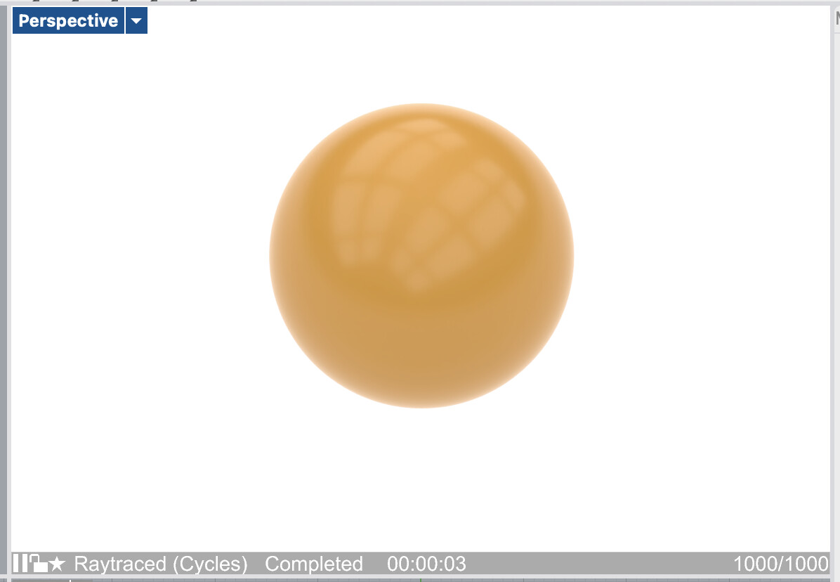

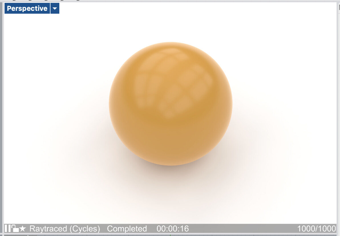

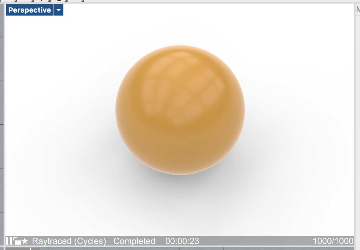

Also I like to turn off the ground plane and use a manual plane instead. The automatic ground plane is huuuuge and will mess with the spatial partitioning causing a small penalty. And the shadows-only groundplane makes things even worse - quite considerably.
shadows-only groundplane: 23s
manual plane / groundplane with material: 16s (in this case due to adaptive sampling same speed)
no plane: 3s

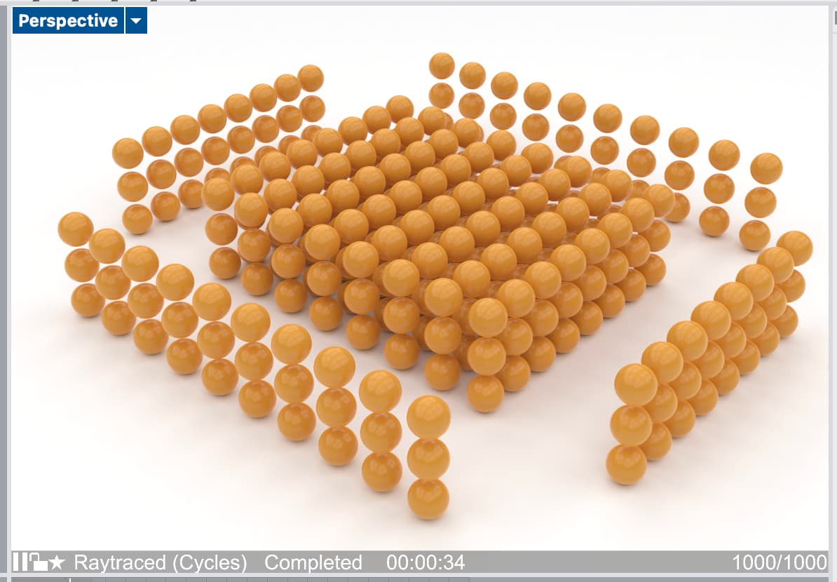

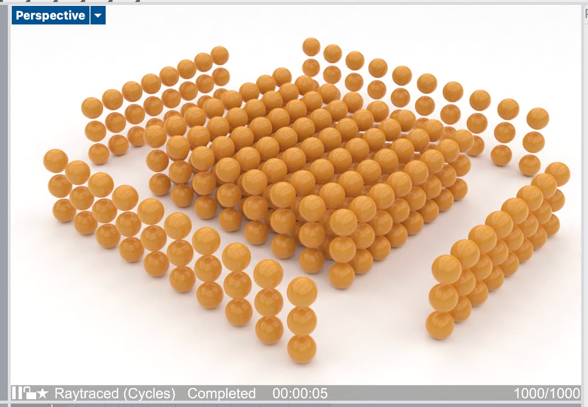

Oh, also, if you don’t mind errors that people can’t see (typically) you can play with Tools > Options > Advanced, type in Search box Adaptive
By default the error margin (threshold) is set to 1% (0.01, probably shows as a looong number, ignore that, it is 0.01). Setting it to something larger can give considerable faster renders. With denoise on it is probably still going to give you good results that you can use.
300 spheres (not spartans) on a ground plane with default material.
Threshold set to 0.05 (error margin 5%), with denoise: 5s
Threshold set to 0.01 (error margin 1%), with denoise: 34s
Play with the threshold to see what your sweet spot is for speed and acceptable render output.
