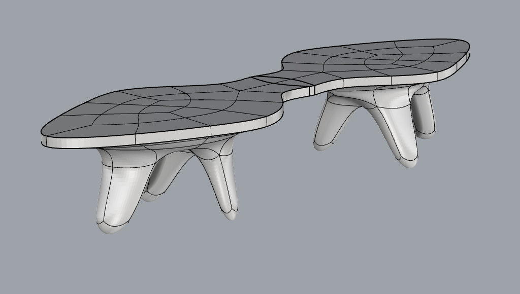

I’ve seen a project on internet and I think this is the perfect exercice to learn more about sub-d.
There is the furniture that I would like to model
So I’ve started from a drawing with front/top and side view
I started from the top curve and extrude step by step and shaping depending the front and side view.
Howerver I’ve done the middle part but If I cap it, It closed with triangles and I can’t use face to make legs so Ive done the legs but I can’t bridged them haha.
So I tried from another perspective by making a face and offset it so I could have some faces to manipulate but it’s not that precise in my opinion.
Any suggestions ? or a way to follow ?
Thank you in advance !
This is slightly confusing. Ppl will need more data.

start with a concept for the facelayout at the bottom.
see lines at left.
try to use quad s when ever possible
try to avoid starpoints, place them carfully.
take care that some commands convert subD to nurbs/polysurfaces.
see other topics

without any shaping / finetuning
it still looks clumsy…
but should show the overall concept.
the concept is similar to @theoutside kyle 's paper doll approach
instead of starting with faces i use lines:
commands used:
initial concept:
_polygon
_line
_explode
_meshFromLines
_toSubD
gumball - Extrude, Scale, Move
_insertEdge
_inset
_extrudeSubD (in UVN system for the edge)
_mirror
_bridge
_3dFace for the top surface
coffetable_subd.3dm (3.3 MB)
