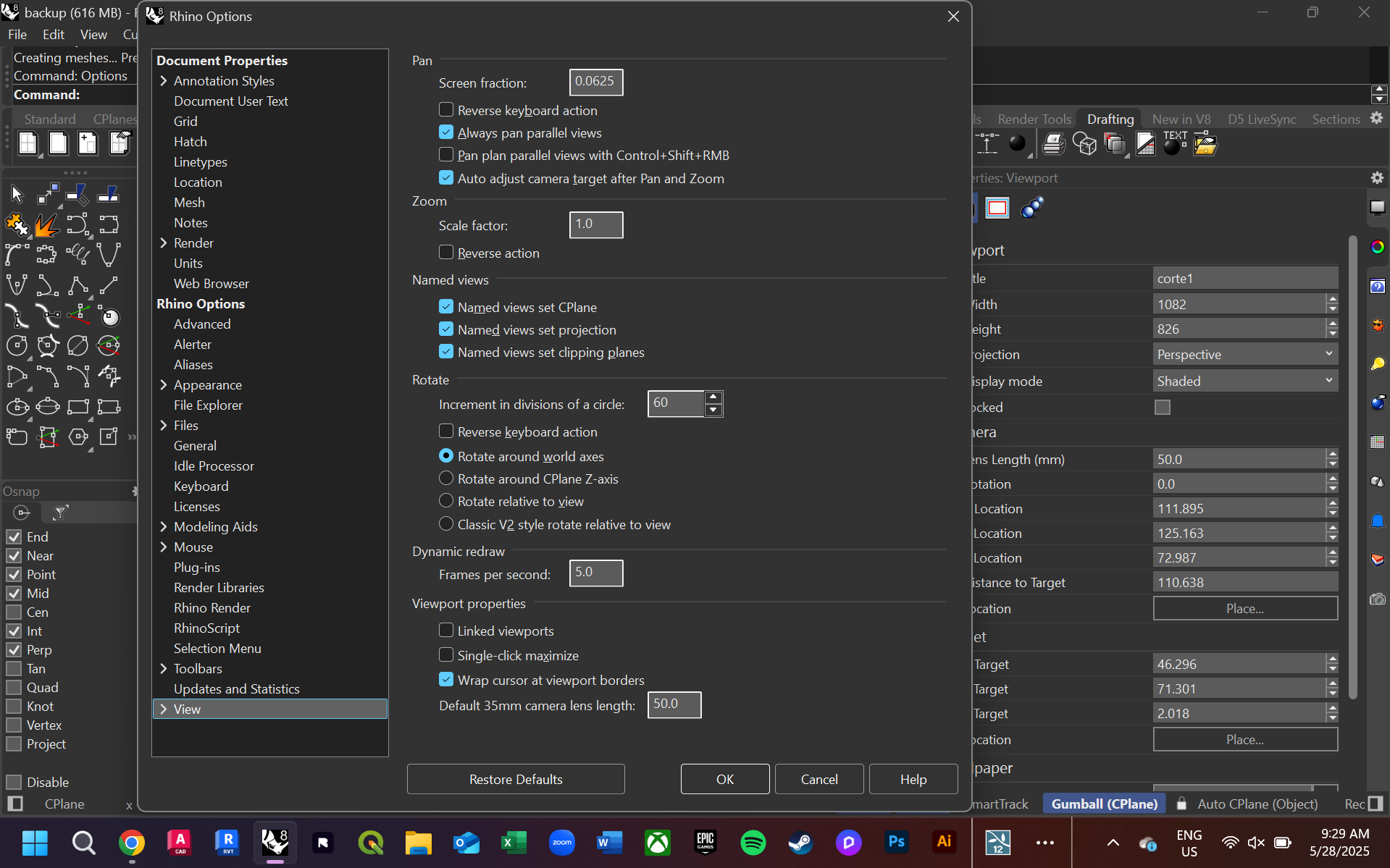

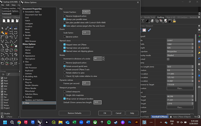

Yes the scroll wheel works normally in any other program, and the issue does persist even if I create a new file or open an existing one

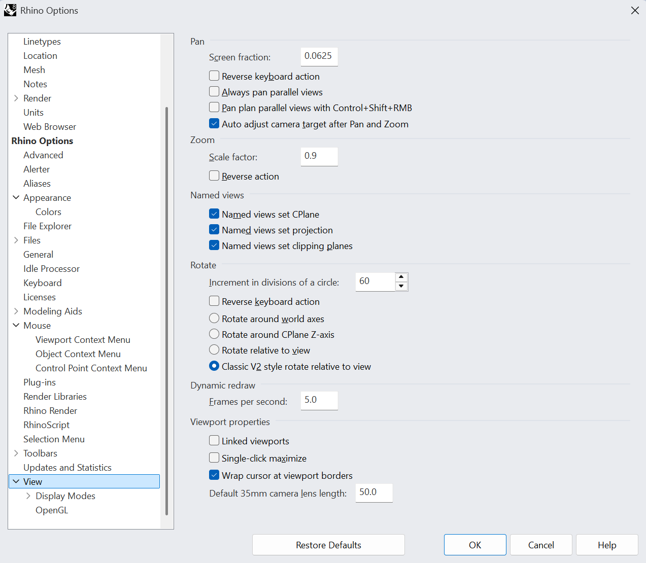

@Israel_Déciga_Becerr can you send me a screenshot of your view settings:
Pls change the zoom factor from 1 to 0.9
I changed the zoom factor and the problem was solved, the mouse scroll wheel now works, thank you Gijs. Do you know what can cause this factor to change randomly or something?
I don’t know, but glad this solved it for you.
