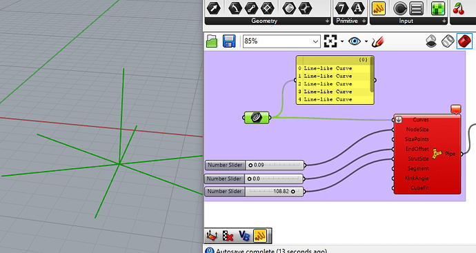

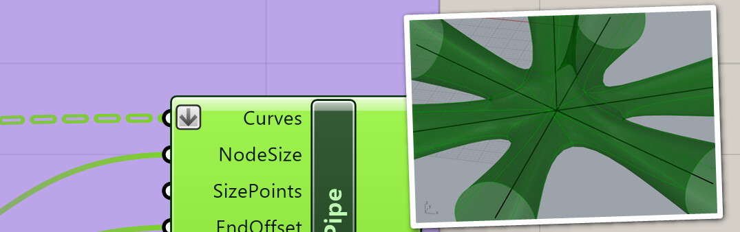

I am working on some complex multipipe structures, very powerful… when it works. Can someone have a look at this small script, I am trying to understand why the first image is not working yet when I snap it to the end as in picture 2 it seems to work?
Now sure why this is happening, appreciate any help

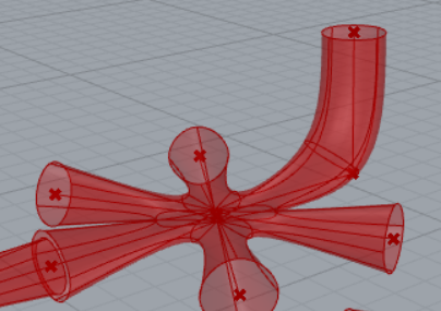

In image 3 the desired result however why does this only work when the curves are individual?
Hi @w1743763
The Curves input is List access type.
So if a data tree is input here, it will make a separate result for each branch.
If you right-click an input you can choose the ‘Flatten’ option to turn your tree into a list so the curves are all processed together.

Hi Daniel
Thanks for your help, I have tried this however it still shows up as an error reading > 1. Solution exception:One or more errors occurred.
