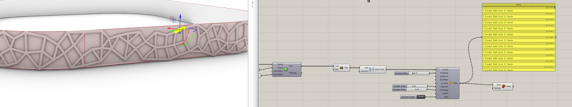

Splits into parts and not into one Multipipe
1
If you want one single multipipe, the end points of the lines or curves need to be coincident.
ืžืขื˜ืคืช ื ื™ื_2.gh (35.3 KB)
They overlap according to what I did, they just go into each otherโ€™s and donโ€™t merge
Proximity3d outputs a tree. You need to flatten it and remove duplicates
I tried and it still splits them, am I doing something wrong?

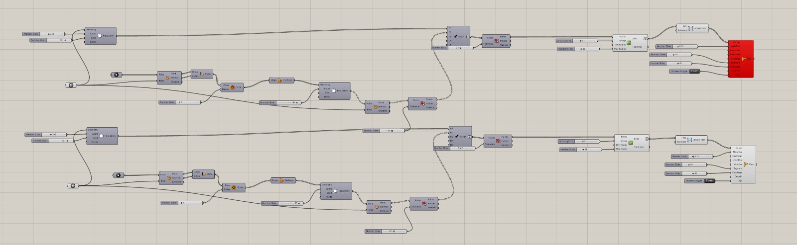

new.gh (12.6 KB)
NIM.3dm (125.9 KB)

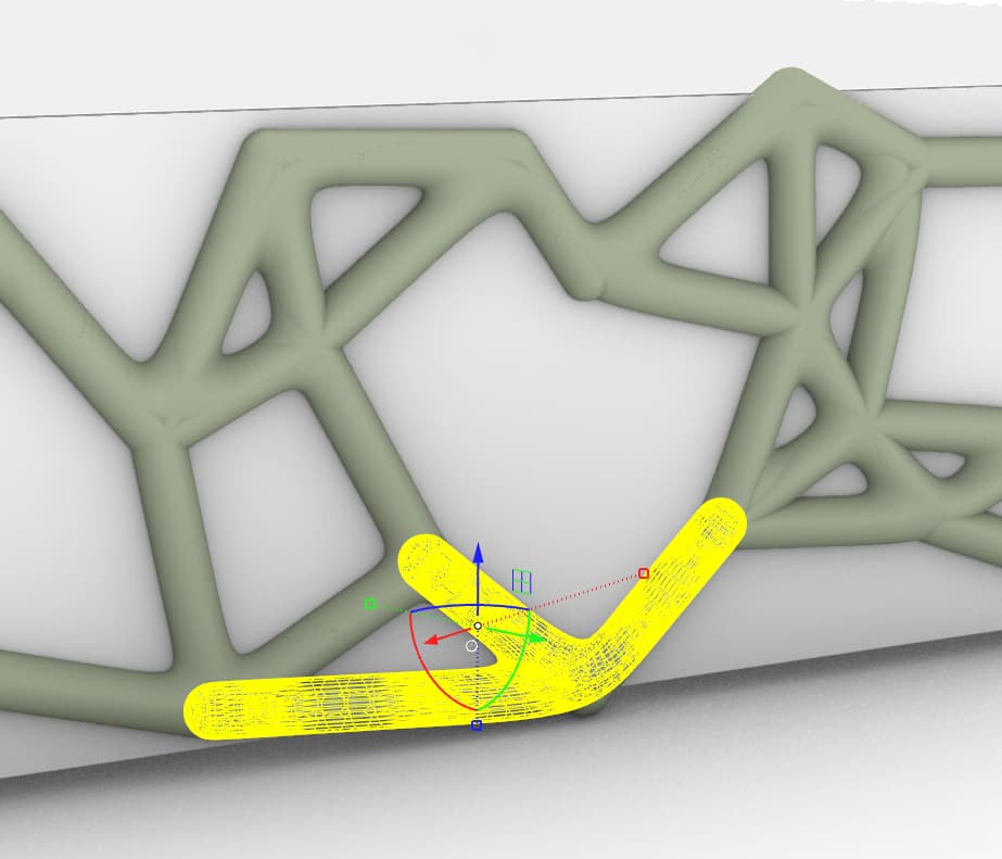

You have the Curves input of Multipipe set to graft (the little up arrow shows this). You need to right click there and turn off the graft option.
I tried that, it doesnโ€™t work. Can you maybe look at the code?
ื‘ืชืืจื™ืš ื™ื•ื ื•ืณ, 4 ื‘ื™ื•ืœื™ 2025 ื‘-0:42 ืžืืช Daniel Piker via McNeel Forum <notifications@mcneel.discoursemail.com>:
Your input geometry was miles from the origin, which causes issues with accuracy and tolerances.
new.gh (14.5 KB)

Thank you very much. It works, but itโ€™s strange that when I try to do the same thing to the rest of my codes, it shows me an error in the pipe. Even when I connect the berp of your code, it shows me like this. Do you know why this happens?
