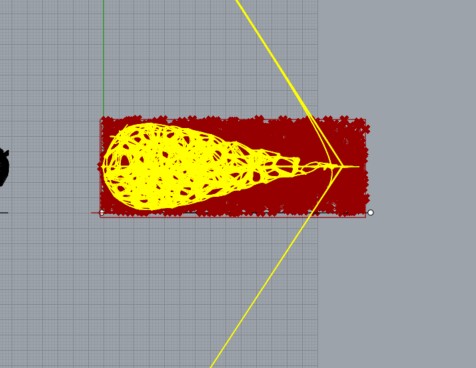

MultiPipe forms spikes
Which settings can I change in Grasshopper to make these spikes using multipipe go away? These spikes do not correspond to curves in the mode, they are artifacts. It is unreliable and the only way to remove the spikes is boolean cutters, so multipipe is less reliable than conventional pipe.
Some of the lines are too short. Have you tried the Topologizer plugin? It can be used to clean up a line network

Works for lines, but doesn’t work for non-line-like-curves.
As a workaround you can convert your curves into lines first. Get rid of lines which are too short and rebuild curves.
