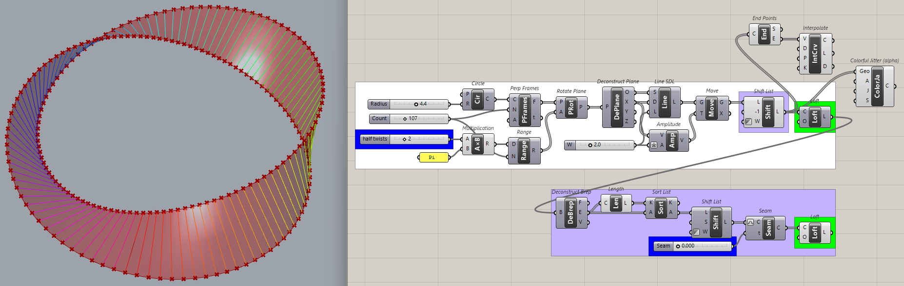

The white group creates the Möbius surface without a plugin, the purple group moves the seam.
Möbius_2024_Jul16a.gh (15.5 KB)
The purple group might work on the Lunchbox Möbius surface?

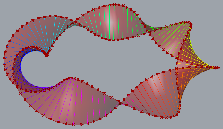

When the number of half twists is odd, you can call it a Möbius strip, though this is a brep not a surface. See the green section to cheat?
Möbius_2024_Jul16c.gh (24.2 KB)
5 half twists:
When the number of half twists is even, it’s just a twisted surface.
twistSrf_2024_Jul16a.gh (25.4 KB)
6 half twists:
I have much to learn. They look so similar yet are so different.

The seam moving solution in my first post (version ‘16a’) still works when the number of half twists is even, but fails when it is odd. Still working on that, but I have two questions:
  1. Should I add it as a feature to creating the twisted surface or separate it?
  2. Does the surface produced by LunchBox follow the same convention regarding even and odd half twists? Per my first question, should moving the seam work on LunchBox output?

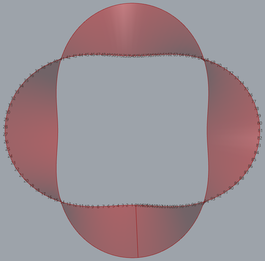

This became way, WAY more complicated than I had hoped. The white group at the top generates twisted surfaces with odd (Möbius) and even half twists. The orange group at the bottom has a ‘Seam’ slider (blue group) that moves the surface seam. Numbered isocurves are used and left visible. One detail from the white group is used in the orange group: ‘odd’ (0 or 1)
twistSrf_2024_Jul17b.gh (34.2 KB)

I was getting exasperated yesterday trying to get version ‘17a’ to work. Then I tried enabling the loft option ‘Align sections’ (‘Adjust seams’) and voila! Success! So I quickly posted it, then realized later that my efforts to flip the last section curve (when ‘odd’) weren’t needed. So I removed those bits in this version.
Then wrote a little cluster (yellow group) to count half twists (odd or even), trying to eliminate the dependency of the orange group for that bit from the white group. Alas, more code re-org is needed to avoid a “cyclical data stream” so I skipped that for now.
twistSrf_2024_Jul18a.gh (40.4 KB)
