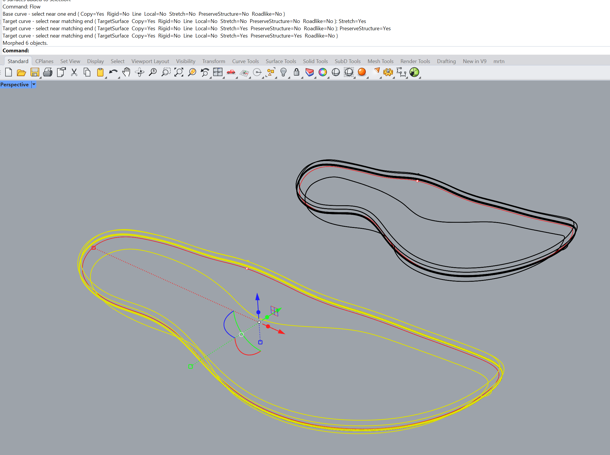

Is it possible to do this, but show a 3d closed contour as a origin and another as a target and the morph happens? And use multiples objects to morph?
What should that be? Can you post a screenshot of your object?
changes.3dm (1.2 MB)
See the file. The surfaces (or polysurfaces, meshes) can be morphed indicanting the source contor and the target contour.
I think you can do this with the Flow command in Rhino
No need for a box in this case.
Here doesn´t work.
I moved the curves into the sole. You see the red curve in my screenshot. Then you might need to click close to the end of the curve. You can run _CrvEnd if you don’t know where the end point / seam is…
hummm the source need to stay near os the geometry. Is this?
ok… I will try!
Here’s how it looks on my end with the curves higher up:
Move them down…
Thanks! I will try!
If I have more surfaces, closing bottom or up, isn´t work. The surfaces are deformed. Do you have any other idea?
Use Sporph in Grasshopper. It uses a reference and target surface.
Ok.. I´ll try…
