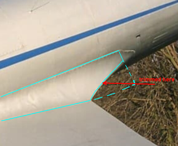

I think your main problem is you are trying to wrap that blend around the trailing edge of the wing.
In the one image that shows the trailing edge it looks to me that the blend between the fuselage and wing just continues straight past the trailing edge and then you trim off a triangle from the blend. Then the trailing edge continues its fairly sharp radius where the blend surface was trimmed (see pic below)
In other words, the blend doesn’t wrap around the trailing edge, the trailing edge wraps around the blend.

First of all I was only addressing what happens at the trailing edge (TE). It does look like the the blend wraps around the leading edge.
On the TE, even if what you are doing made a nice surface it wouldn’t look at all like what the picture shows is on the airplane. The trailing edge looks like it stays a sharp small radius until it gets pretty close to the fuselage.
Something like this:

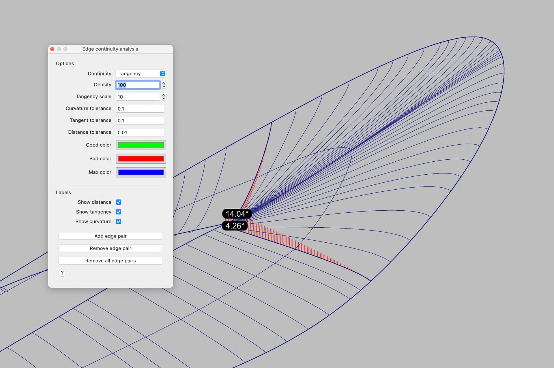

One question already, I can’t understand why the BlendSrf creates the two hard “creases” or lines exactly where I added control handles. How can I clean this up?

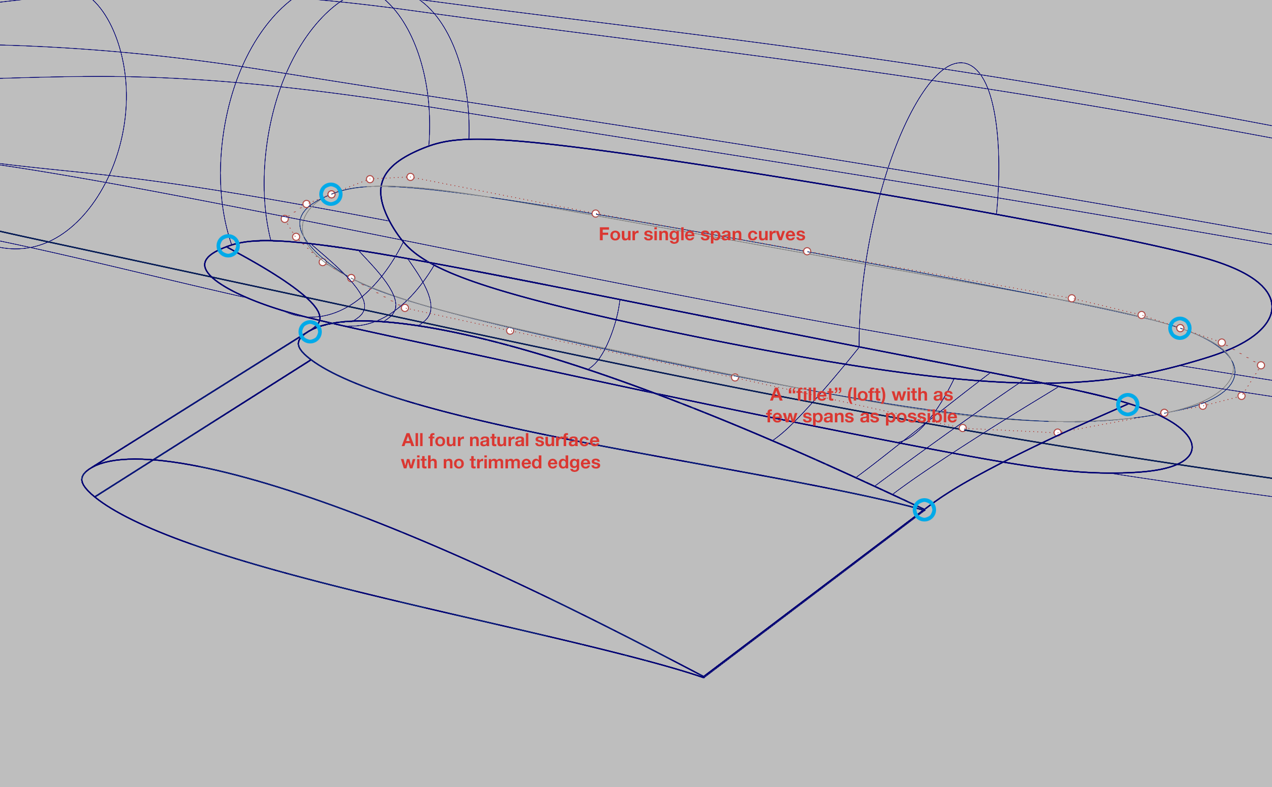

Could anyone tell where I’m wrong and why that crease is there? I can’t “puzzle it away”
Your surfaces are not tangent, hence the broken highlight (crease) on both sides.
Maybe try something along those lines. Build the wing surfaces single span without trimmed edges. For the “fillet” contact curves on the fuselage, find the four points where the curvature starts to accelerate (see your original one-piece curve side on), and then draw two degree 6 or 7 single span curves between those points, then use two blend curves left and right (I did not spend time to match yours exactly). Then you can build a simple loft “fillet” towards the fuselage and match that G2. Then do the same on the bottom of the wing. Only then, when those two surfaces are as simple and clean (look at the CP structure) as possible, attempt the “peaky” surfaces left and right.
For even simpler “fillets”, consider building the long top and bottom surfaces in two parts, using a degree 5 section from the highest/lowest point of the wing edge to the fuselage.
