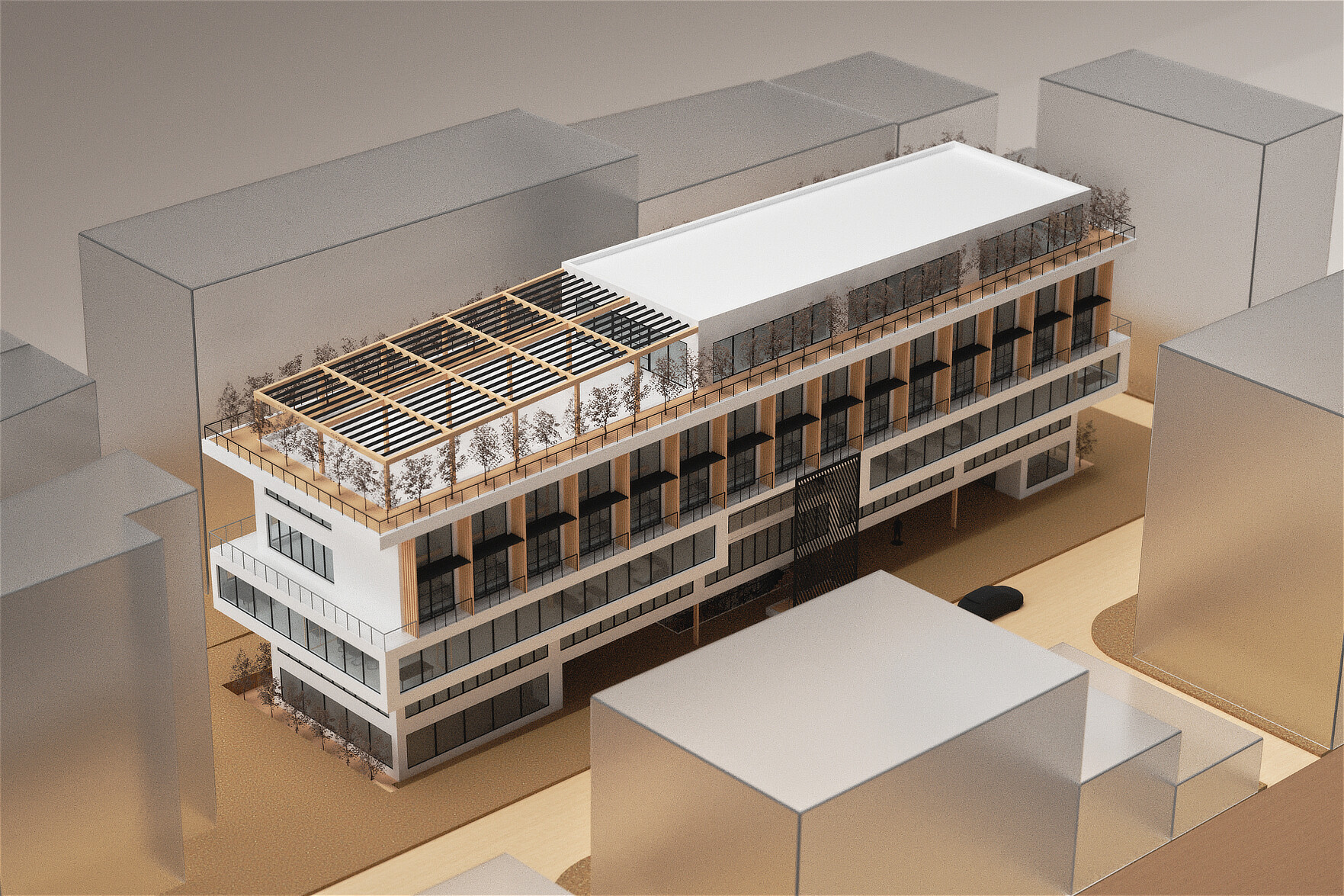

Model Render with Rhino's Cycles
This is for a university project one year ago. While the engine is not going to replace any 3rd party rendering engine soon, it’s still very impressive what Rhino can do on its’ own.
what would you wish cycles could do better or what is missing?
It’s not so much major features but comparing to the granular control Blender’s cycles gives you the difference is a bit stark. If I had to give bullet points of the things that I can think of immediately:

Sample count you an already change since Rhino 7. In Rhino 8 check in the advanced render settings section in the Rendering panel. There you can also set different bounce counts. Additionally you can check a couple of render passes, most interesting material ID and object ID.
There is no triplanar mapping, nor texture randomisations at this point.
