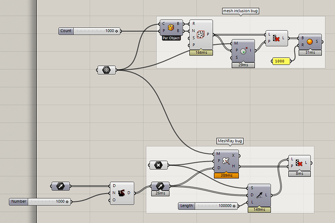

I’ve just checked the latest release candidate 7.2.21005.13001, 01/05/2021
Intersection and inclusion work as expected but MeshRay became really slow comparing to Rhino 6 (4 seconds vs 389ms). Please see the screenshots

Hi Giulio
here is that sample
mesh-bug-rhino7_upd 2.gh (37.1 KB)
I have some good news for the upcoming SR. RH-62219
