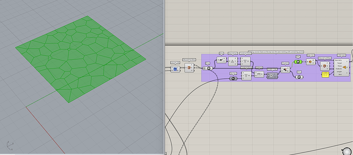

Mesh points along curved 3D Voronoi box
[pic 1]
I’m trying to construct a brep of the top face of a curved surface (pic 2) instead of a flat plane as shown in pic 1.
