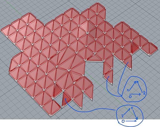

I’m new to Grasshopper and I can’t figure something out…
I’ve generated a triangulated mesh and extracted all the faces, edges, vertex normals and face normals. The one thing that I really need but can’t get are the edge normal vectors.
I can calculate this vector but how do I return the faces of a shared edge?
Is there maybe a plugin for this? Rhino 8, btw.
Thank you in advance!
There used to be the Sandbox plugin but you can use a small script too.
I think Daniel Piker posted this a while ago.
File with c# script which outputs internal edges and indices for left and right face:
mesh_angles_c.gh (31.2 KB)
This one here uses a kangaroo component to get the hinge points:
mesh_angles_gradient_c.gh (39.2 KB)
Thank you very much! This is the magic I needed!
See attached as well (conn is about the adj Faces indices).
Mesh_EdgeNormals_V1.gh (128.3 KB)
