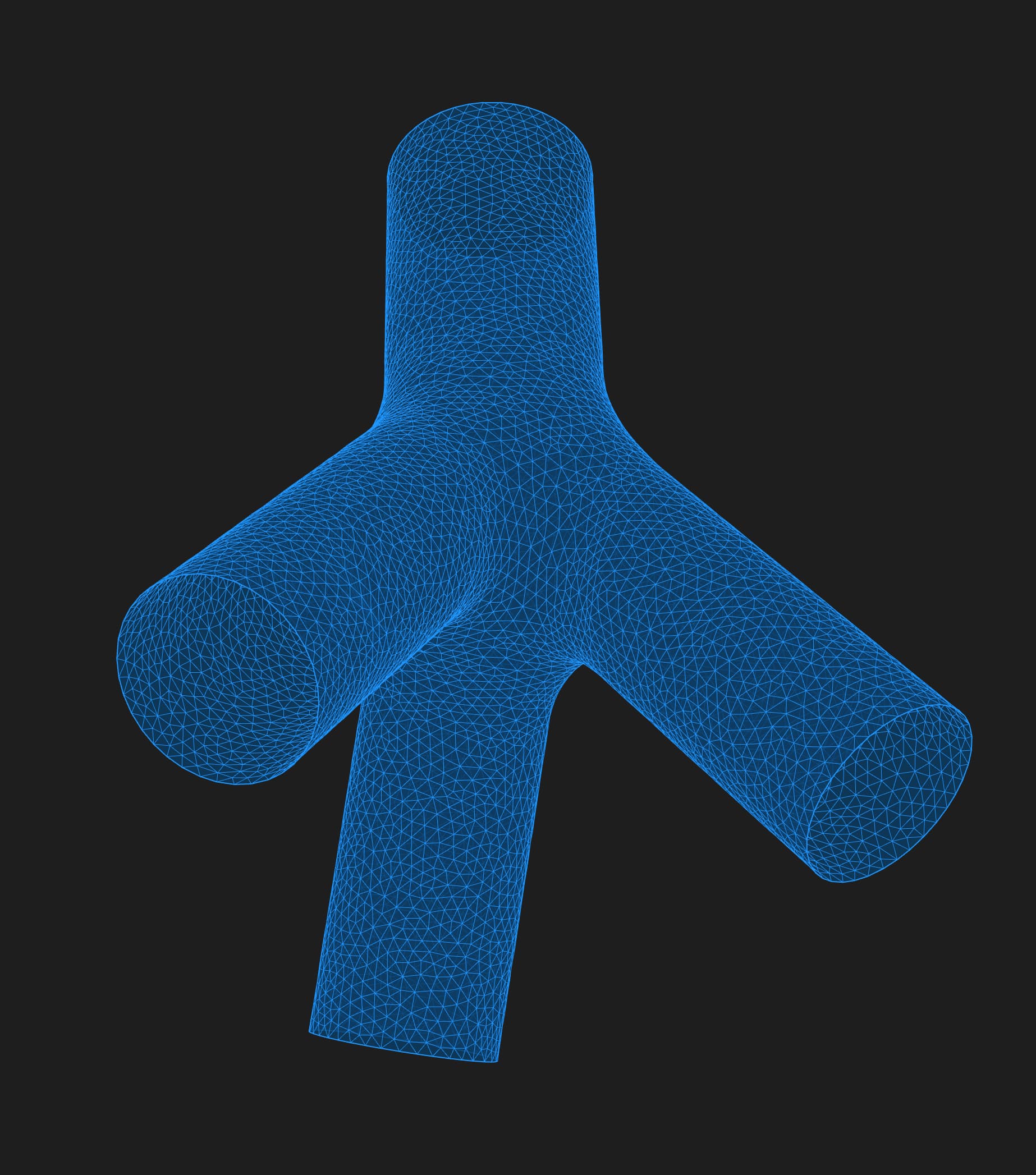

I have a simple triangular mesh that has been capped using the “Mesh Cap” component, and I would like to subtract it with cylindrical meshes using the Mesh Difference component, but I end up with a rather ugly output mesh. The second problem I ran into is that the mesh is not quad remeshable using “Quad Remesh” (weird but, the same command in Rhino works reliably well the same mesh), whereas applying the “Solid Offset” component to the mesh preliminary makes quad remeshing possible. Can anyone give advice on these issues?

Initial triangular mesh:

Flip the normals of your mesh
Thanks for the answer, is there any successful result? Neither Flip Mesh nor Mesh Flip components help me.
Use this.
Thank You for helping me out! It’s solved the problems

I could not immediately locate the component used in the original script. Something seems odd with it. Here a simple script that works.
    if (m != null) m.FillHoles();
    A = m;
Rhino knows how to cap the holes in a mesh. I’m sending the right incantation your way.
I’ll add a reminder for David Rutten to add this. RH-80087. It’s not a complicated script.

It helped me a lot! Thank you for your attention!
