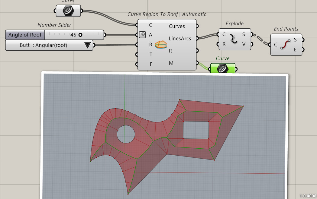

I am currently working on a topology optimization task and have a 2D mesh, may I ask is there any workflow / ways that I can extract the medial axis (red curves) from the mesh or its smoothed naked curves? Thank you very much!

There many examples on this forum of tools to find Medial Axis.
Here one result using curve

Yes I use one like this and one more “geometric” but under the hood it transform curve to lines and arcs then it make a “roof” => 3 types of medial Axis
Butt, Round, Square
