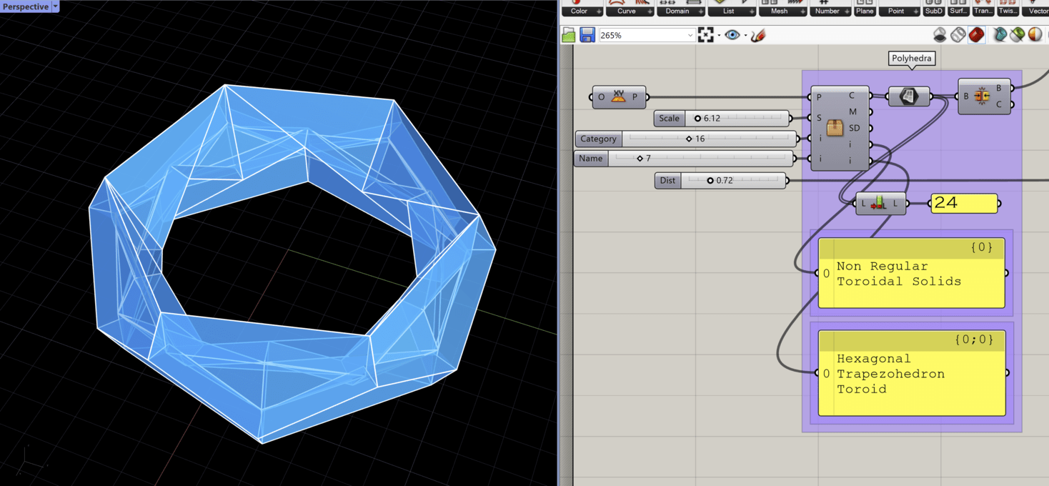

I used the RhinoPolyhedra plugin to try to break Petras’ example, but the component is pretty damn robust. I love it! Here’s my definition for testing it:Ngons almost holy grail miter-izer.gh (449.0 KB)
The example above has some valence 4 vertices that work. When testing I did a lot of very close zoom-in inspections. In some cases, like with geodesic triangle spheres, the errors are tiny, in the .001-.005 unit range. When a high valence causes a failure it looks like this:

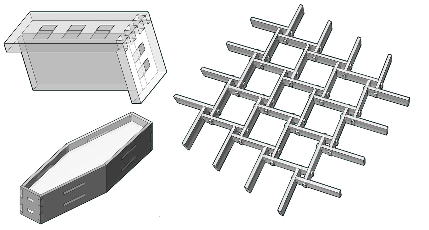

For manufacturing inspiration, have a look at this old plugin…
TIMBER PLATE STRUCTURES
It generates a sort of dovetail along the edges.

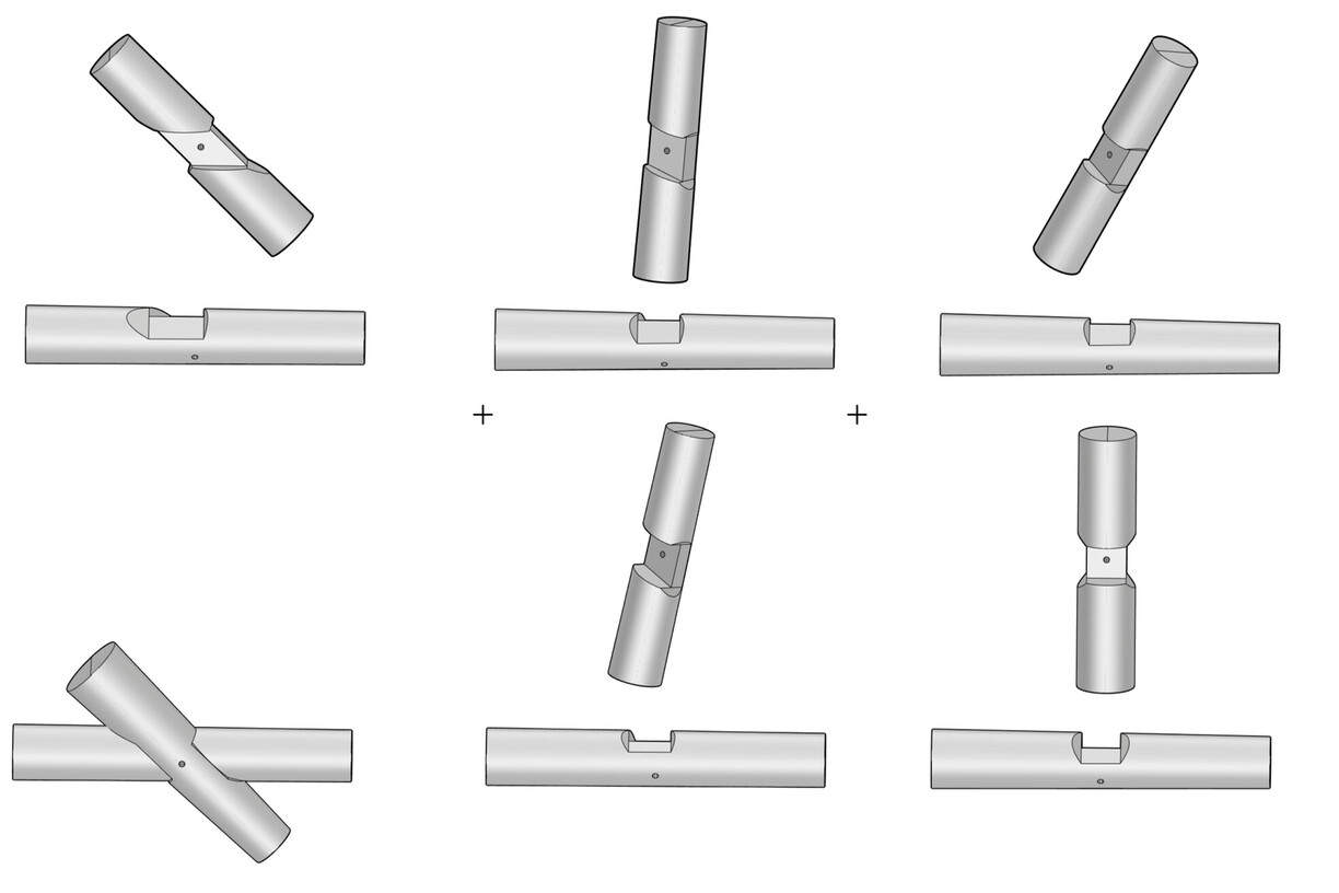

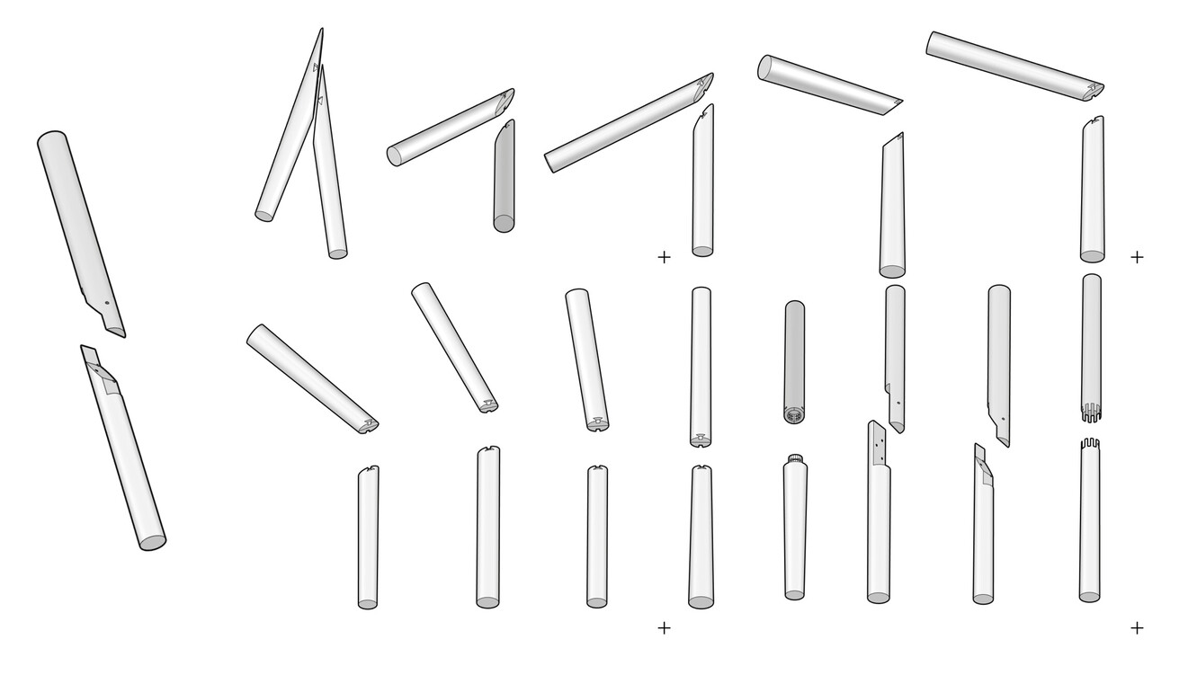

Regarding timber joint. We had lots of discussion in past years how to continue with the joinery development. The idea was not to rely on one structural morphology but rather start from element to element joinery relation, whether it is a beam, plate or raw-wood. There always will be a design model but at the scale of the joints it is possible to create a generic code to avoid another pile of code just to model end-end, side-end, side-side or half-lap joints.
On one hand you might say, if you develop joints locally without relying on fast mesh data-structure, your code will become slow, but this prevents from making modular joinery methods and reuse code in general. In the end we could apply fast collision searches i.e. bounding box, line-line, curve-curve, face-face, plane-polyline to speed up the process. And there were tons of help from McNeel forum to help me through the process. For sure, every project has it`s own specificity but at least we could start not from scratch.
I had to help for developing further old projects that were already published and learn from new ones.
Then gradually we developed ideas and code for local joinery conditions. The goal is that a user could design a model using basic elements and then a solver would create joints. And then when it comes to teaching, students could at least get research inputs for more common projects. For those, we had difficulty before because the only answer was to “code it yourself” which resulted in Grasshopper spaghetti or C# spaghetti or use CadWork. An then you need to consider fabrication tool-paths especially for 3d joints because there is a tight relation between robots or cnc machines and those geometries. While these are just pictures, we had recently made a workshop where I could already apply some methods for teaching.

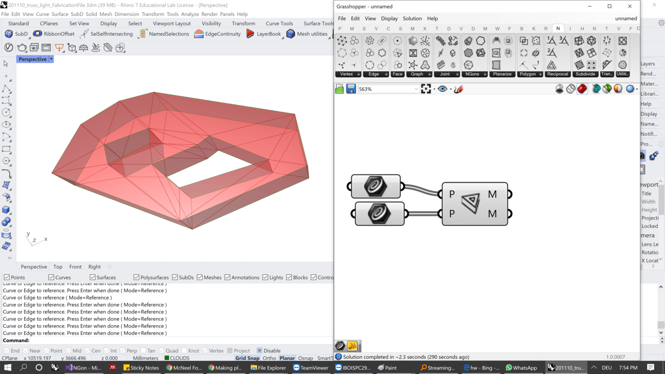

I had a little bit of time to go through your definition @Max3 .
To have a bit safer solution I added the method you used in Python as a component to add planar ngons and then simplify the mesh topology, in case there are unnecessary vertices, which I suspect was causing a few issues. Also I added mesh loft with holes, which works better that the standard loft component (now it is not relying on 3rd party libraries and is not crashing as before):
I had to update the plugin, because I found a few bugs, new version 2.4.3:
