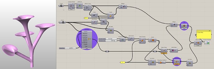

I have this tree structure generated but not sure how to continue from here to link it to the platforms. How can I use Kangaroo to complete the structure or start everything from scratch to make a full tree structure with the platforms?
Rhino file: tree structure.3dm (102.8 KB)
Grasshopper file: platforms.gh (33.2 KB)
I think you can achieve it with MultiPipe + Loft + Split Brep Multiple, and fyi.
TensileTreeStructure.gh (23.0 KB)
  1. Multipipe Grasshopper Online Document
  2. Loft Grasshopper Online Document
  3. Split Brep Multiple Grasshopper Online Document
Looks good! Thank you for the help
