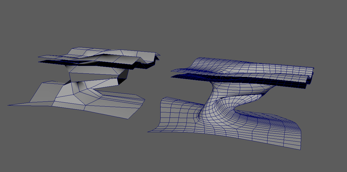

Here’s my guess at the input coarse mesh.
Making these starting meshes for more complex topology just takes a bit of practice.

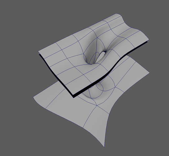

Unfortunately, I still have not found a way how to make a swirl opening between two surfaces.
As shown in this image, the swirl connects to the floors through openings.
Mr. Robert, the maker of this design made this probably by hand. However, I am looking for a way to do it parametrically.
Starting with two surfaces. I can make a hole in the surface and then bridge the surfaces somehow. However, it does connect the floors.
This loops surfaces, but does not connect floors as in Mr. Robert’s principle.
It does, remove a face for exiting and add some twisting.

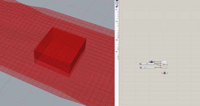

Do you might know how to smooth this in Grasshopper?
problem loophole 01.gh (25.3 KB)
Weaverbird plugin
Your mesh is horrible, there are some self intersection.
It you can take care of that Catmull&Clark could be a good way to make it organic.
If you are just doing one building, stay in Rhino and make a good mesh by hand. Then SubD (with Rhino 7) or Mesh + Catmull&Clark (Rh6+GH1)
Yes, I know WB, and my mesh is not horrible… it is just connected to the other mesh. There is no self intersection for so far I can find.
I tried Weaverbird already, but it makes it look like this. Or is that what you meant I should make to make it more organic?
My bad ! Organic is smooth, so what do you don’t like after Catmull&Clark ? You could play with the S option if you want to keep edges/corber fixed.
What did you expect?

That is not the same topology as you have in gh, I’ve sent you in pm how that should look, it should double back on itself which also makes a thickness. Look at the file i sent you, it is clear what you have is not the same.
Twist Connect.3dm (185.5 KB)
Yes, I know it is not the same topology, but I am trying to make something similar to “that” related to the previous shown references of Robert’s design.
I am trying to do it with this mesh, within this set box boundry.
Twisting it or something and then removing some faces somehow to smooth it and get a something similar result like as your given example.
problem loophole 02.gh (61.5 KB)
What you have:
What you are missing:
The mesh needs to double back on itself for that topology. That is what my mesh is doing.
