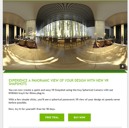

I just got a notice about using Iray for making backgrounds which could also be used as environments I think.

Im currently use Nvidia Iray for rhino and getting better results early on than I got after years of using Flamingo NXT.
Iray uses GPU & CPU and you can select GPU or CPU only. it does however use HDR file formats to light a scene.
Have you Tried Iray ?
just had a look at the Thea render site, that product looks very good also. the clipping plane support looks handy as you suggest.
Iray for Rhino does not yet support Rhino clipping planes.
