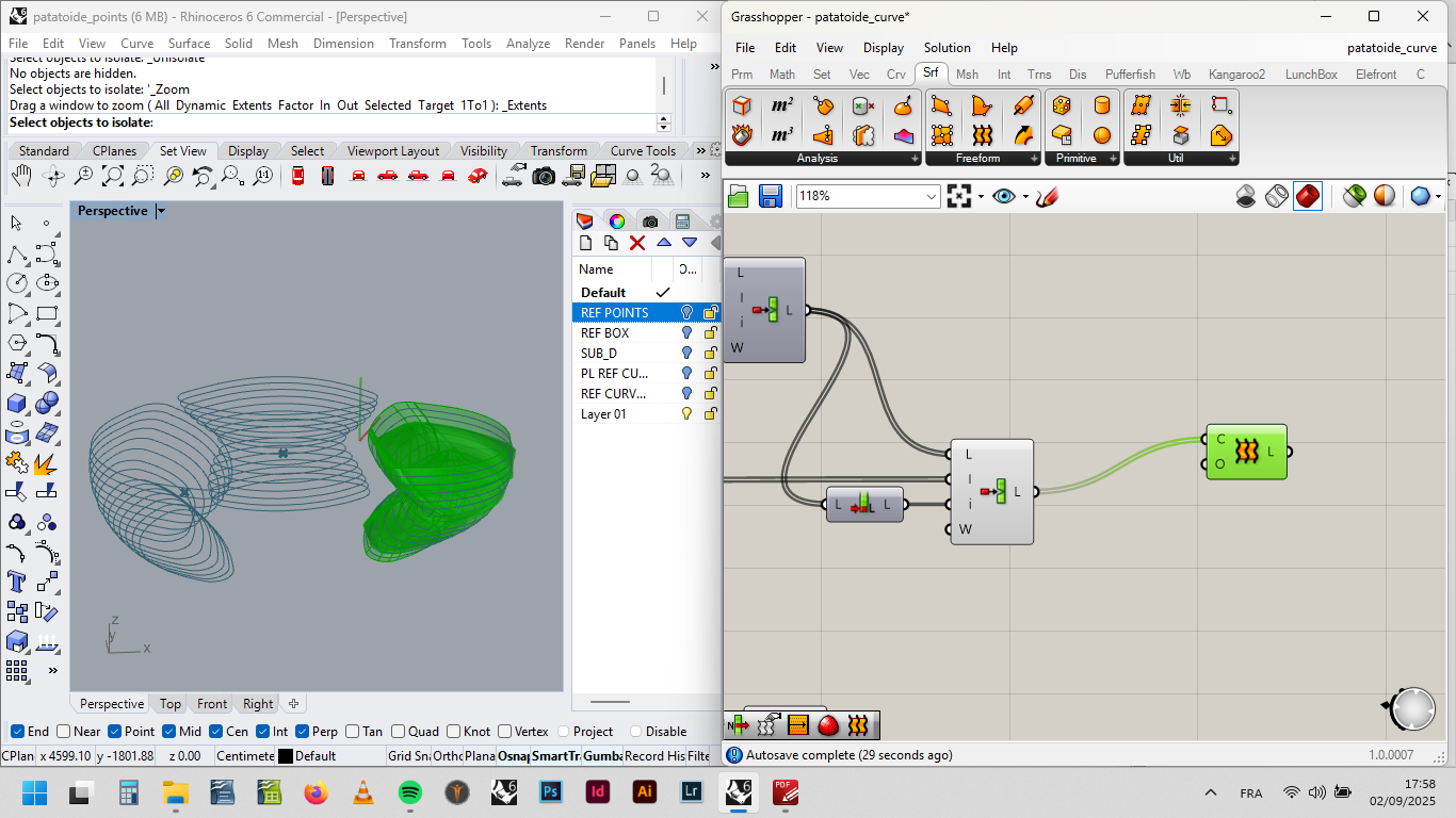

I’m trying to make a loft between curves. I manage to sort in order these curves but loft result doesn’t fit curves…
Here’s the file with internalized data :

Don’t flatten your tree.
patatoide_curve.gh (55.4 KB)
And look at the loft options…
Hello @martinsiegrist thanks for your answer, i like the way you ordered all curves with “sortlist component. What is the use of “Shiftpath component ?
Have a good day :wink:
Look at the tree structure of the R outputs on the Region Intersection components…
It contains each curve in a list.
To be able to loft the three sets individually, you need three lists with curves and the shift paths component basically flattens the number of levels you specify.
