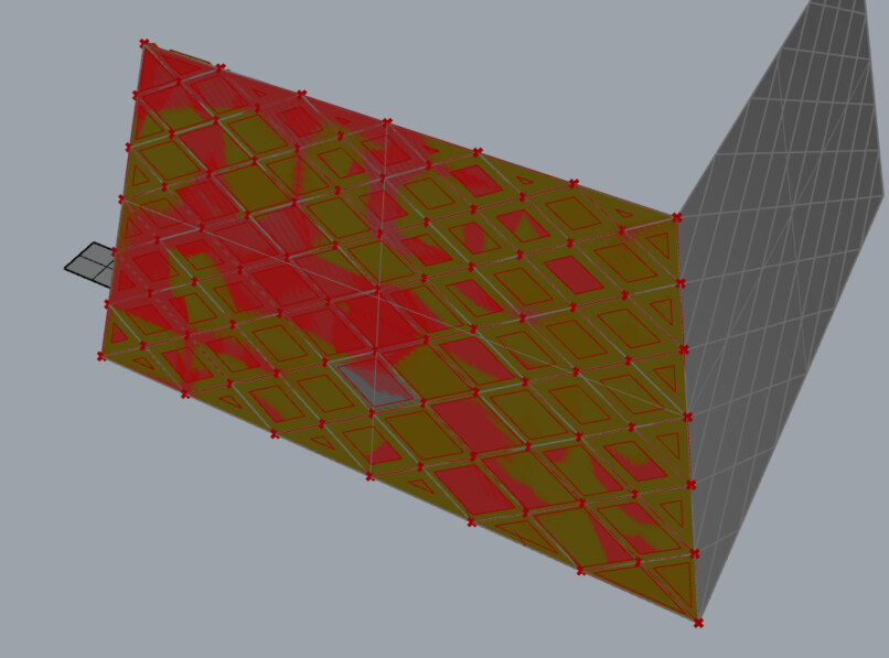

Hello, I attempted to create surfaces using both the original separated rectangle surfaces and surfaces that have been offset or moved, but the loft command failed unexpectedly. Can anyone provide assistance in resolving the issue?

That is because your input surfaces face different directions.
So first you need to unify the face directions or unify the Brep edges’ curve direction, then do the offset.
