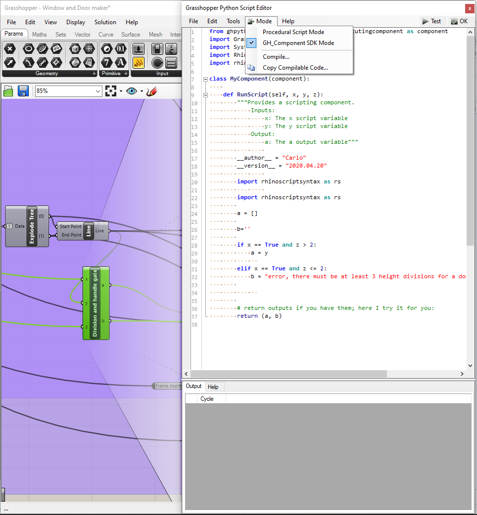

So i got this message via email when i tried to upload a gh definition with a few different extremely basic python script comonents in there. I’ve tried to find some documentation on the problem but cant seem to find anything. Am i missing something obvious??
the only other problem that it could be is that i havent compiled my script to be GH components?
see picture for the sort of script components i am running

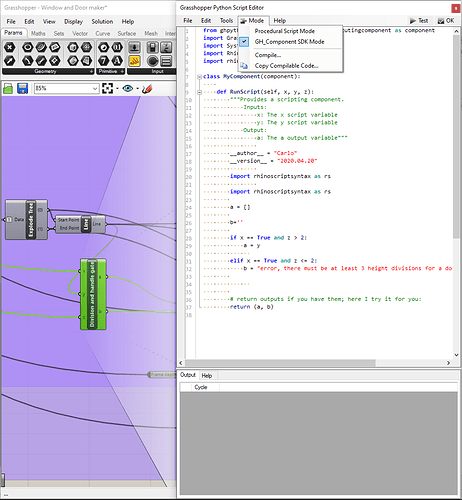

Could you share a minimal version of your script that produces the issue? It seems that this is simply linked to the version of the Python component you are using, I suspect it is an old version of the Python plugin of Rhino 5. In that case, if you share a model with one simple python script, that should be enough to identify the issue. You could also let us know which version of Rhino/Grasshopper you are using.

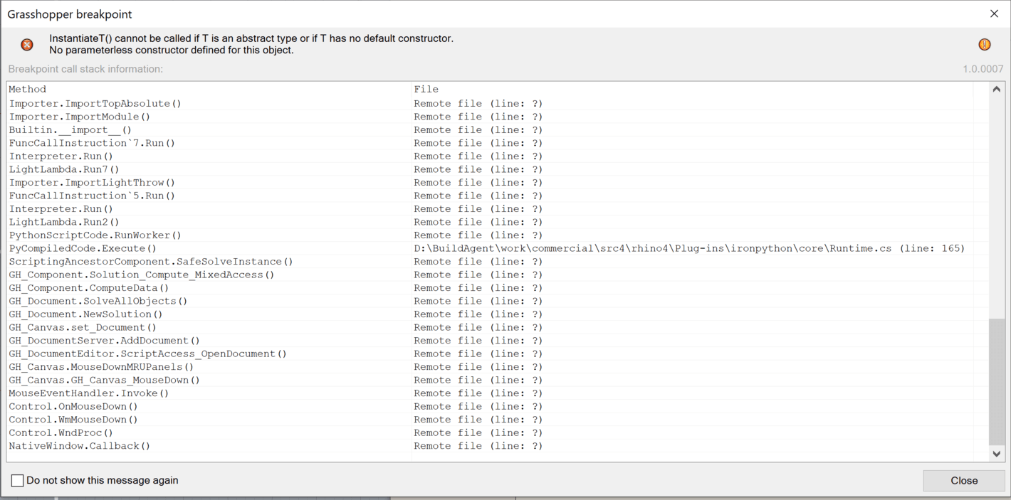

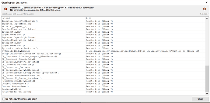

I could upload this minimal file to ShapeDiver without problems. However, when I opened it locally I got a series of warnings, including one related to a Rhino 4 reference:
I think you may be using a quite old version of the GhPython plugin that was created for Rhino 4 & 5. If you are using Rhino 6, you should delete this plugin and use the component included in Grasshopper out of the box.
If you send me the ghx version of the minimal script (sorry for not specifying this earlier), I will be able to confirm the issue.
