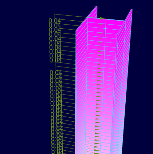

I am using Karama 2.2.0.10. When I change the input length unit to mm the material properties are 10^6 to high which lead to bad results. Is it a bug? Or should I change something in the ini file?
E should be equal to 3300 kN/cm2
Also the forces are visualised in kN/mm while I would rather see them in kN/m. Can I change this in the settings?
acting load is: 40 kN/m

thanks for your bug-report! There is a conversion-error in reading material parameters from the external database. Sorry for the inconvenience. I will fix that as soon as possible.
Regarding the force units for display: In the next service release there will be a corresponding setting in the ini-file.

there is a new service release (see https://github.com/karamba3d/K3D_NightlyBuilds/releases/tag/2.2.0.11):
  • The conversion bug is fixed.
  • The numbers at the load-symbols are now shown in the correct unit.
