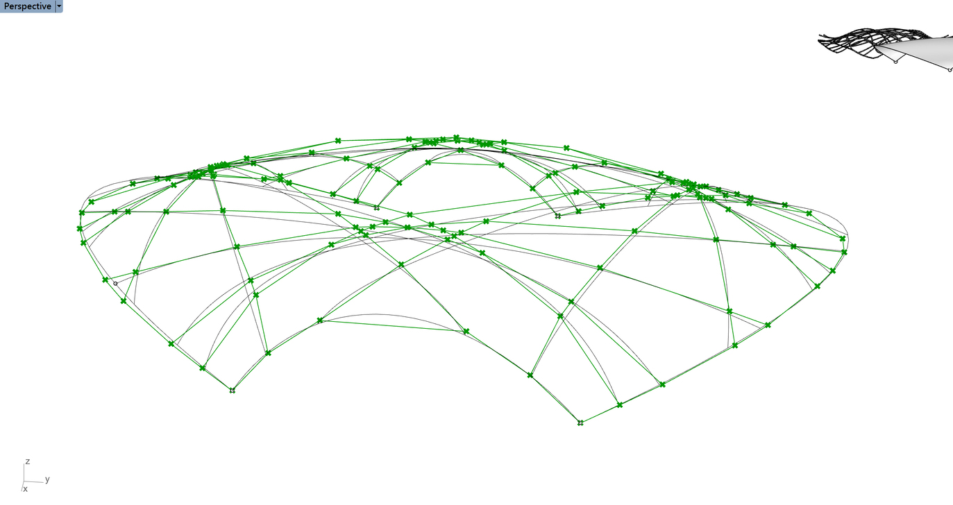

Recently, I was trying to simulate bamboo structures.
The top scripts can simulate successfully
However,I would like to add more points between curves for simulation.
it gonna have problem of kangaroo.
I discovered that if I enabled the “show”, color of kangaroo componet will be normal.
I pressed button to simulate, the green geometry showed immediately and then disappeared.
So, I have no idea how to fix the button script of picture. Try_tutorial_rivised.gh (44.3 KB)
It’s because some of the points are very close together and segments are getting collapsed in the initialisation. Change the tolerance setting to 0.0001 and this problem goes away.
Also - for this type of non-developable gridshell it can sometimes be good to let the crossing points slide along the rods during the form finding. I did make a while ago a new goal for this - I’ll try and post it soon.
