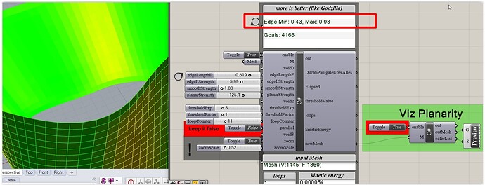

I’ve been trying to planarize the panels of a free-form geometry by using Kangaroo2… the problem is that the form I get is very different from the original one as you can find in the attached photos:
The original form:
For the highlighted number slider, I start with 1 then I increase the value as the solver runs as I’ve seen advised in other related questions on the forums.
So can anyone advice what should I add to my script to stay as close to the original form as possible?
I’m in a desperate need for help…
Thanks in advance!
It just isn’t geometrically possible to have flat quad panels with that grid while staying close to that form.
To be planarizable, the grid needs to follow the curvature directions.
Here it looks like you’re starting from a twisted ruled surface, and the ruling directions meet the boundaries at a skewed angle. So a planarizable grid here would need to have some panels cut diagonally at the boundary. It might need some internal irregular vertices too.

I attached here the script I used to create the form from the beginning and turn in into a mesh.
I would be really thankful if you could advise what should I exactly do to make it possible to planarize this form, or maybe provide me with a link to some tutorial or anything that can help.
Think K2 as an app that allows you to get the proper Lambo for you. So you input a Goal related with your wallet depth ( 0 to pos Infinity) and a Goal related with your Lambo desire (1 to 100). If these Goals point North/South … well … you’ll end up with a Skoda (at best).
Back to your Mesh. The metaphor means that you (a) should never over constrain your Goals [for instance the Anchors used] (b) you should never expect wonders most notably if the Mesh is closed in U/V. That said the close to the OEM Surf Goal is also a rabbit hole (unless you put K2 in a C# Loop > relax > measure results and deviations > evaluate the state of the solution using some MOO approach > if not OK (never is OK mind) > again > and again > …).

If by that you mean BrepFace that’s easy. If you mean any Brep (i.e. a collection of BrepFaces) … well … that’s a bit tricky. Better describe your goal/trade: are you in the AEC market sector and you want to create a “planar” quad envelope? are you an Artist ? And why you bother about some “as close as possible” Goal? (i.e. the OnMesh IGoal (*)) What’s the purpose? Who’s gonna notice any difference/deviation?
(*) in fact that’s complex: imagine a Surface/BrepFace that yields the Mesh to planarize … AND THEN the Surf or the Underlying Surf (case BrepFace) is expanded (N/S/E/W): that would be the " template" to follow (allows some freedom to that poor K2). But what happens if the template is closed in U/V? A strangle to death situation for sure UNLESS you add a IGoal that srinks a bit the Edges (trying to avoid the obvious). That does the edgeLengthF var (edges strink if is < 1) in the pics posted above.
