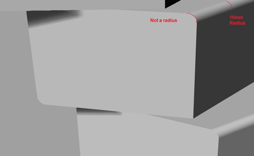

I have tried to do it with by tweening curves between the outer edge and offset but because the large rads in the corners are not actually radii everything seems to not quite work.

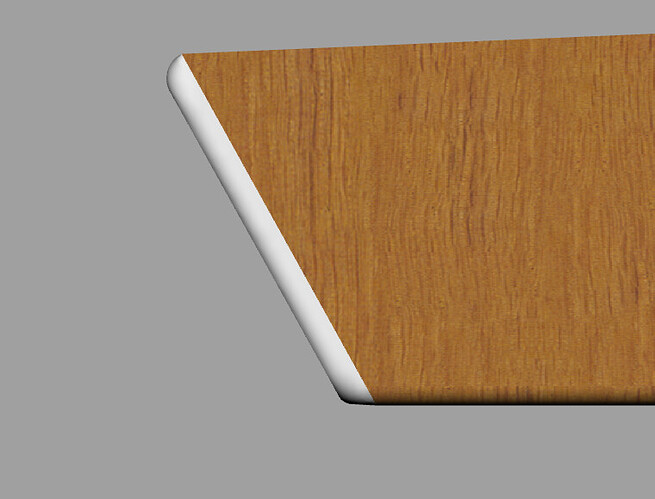

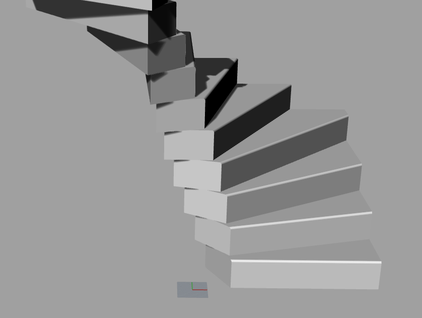

The end product is an end cap for staircase steps. Each step is a tapered plywood box with radiused edges that are cut at an angle…

Attached is a rhino file of a step. I am trying to make an oak cap 23mm thick that fits on the smaller end and has a nice radius around its edge such that I don’t get an overhang to machine on the back of the cap and a tangential edge on the front of the cap…

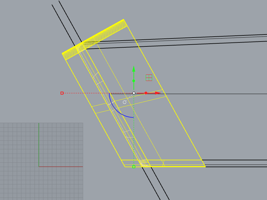

You can blend two surface edges. I find this complicated. You need to add slashes for the corners. And I cheated by adding a small fillet on the sharp edges which will probably be rounded a tiny bit.

It looks like part extending surfaces but then extruding the surface at the back of the step to avoid the overhang and keep it perpendicular to the stair cap (which is exactly what I need but I can’t figure out how you did this)
As I understand it, the workflow is this…
Extend / Extrude stair surfaces
Create plane surface at end of stair
Offset this by 22mm
Cut Extruded / Extended surface with offset and planar surface
Cut planar surface to fit end of stair (including cheat radius!)

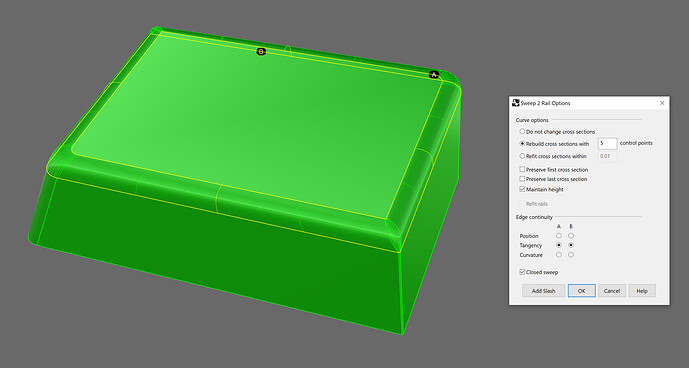

For the second last step I first created an offset curve. I deleted the corner two segments on the corners where the step has fillets. Then I filleted the four corners of the offset curve with a 2 mm radius. I turned this into a planar surface.
Circa mid edge on each straight edge I created a perpendicular plane and used these planes to create e section curve between the two edges.
I used the green surfaces and 4 blended curves for a Sweep2. I added two slashes on each corner. Note it’s not a blended surface, it’s a sweep.

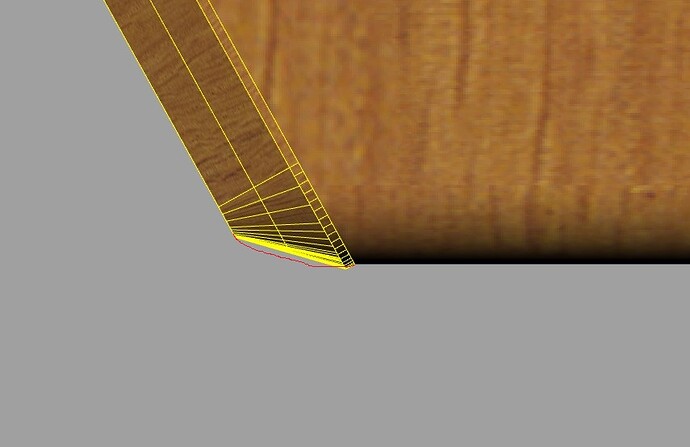

I can’t get the end result, when I join the 2 planar surfaces and the sweep2, to be a closed polysurface and I can’t keep the cap tangent on the front end of the step despite selecting “Tangency” on that edge when I create the Sweep2… I noticed your example did not retain tangency either and it looks like its the corners bulging.
