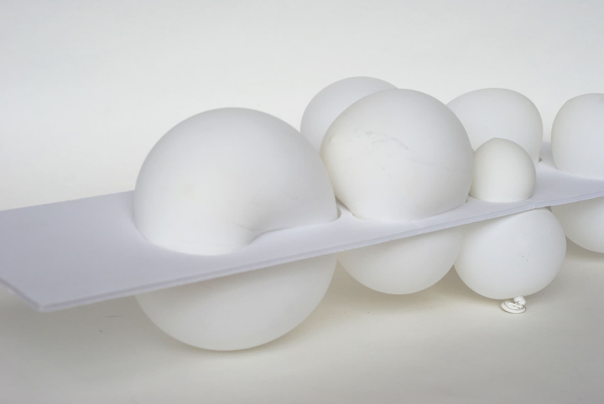

Hello. I’ve been trying to figure out how to make these soft bubbles react to the rigid surface on top, recreating the effect shown in the balloon image - like the squeezing out form. I would really appreciate if anyone can help me figure out what I am doing wrong :confused: thanks so much in advance!

As far as I can tell, there are a couple of issues with your geometry that prevent this from working:
  • two of the base curves that you generate the meshes for the soft bodies from already intersect on the XY-plane, which is quite tedious to remedy with Kangaroo, better take care of it before the simulation
  • you generate the soft bodies as mesh surfaces, which might work for the inflation but is probably problematic for checking soft body collisions
  • your rigid collider is an open polysurface, whereas the SPC (Solid Point Collide) component from Kangaroo explicitly relies on a solid
  • a specific situation with the geometry of your rigid collider produces non-manifold edges, which should always be prevented, simply add a tri in “front”
In order for this to work, I’ve slightly adapted the geometry of your rigid collider and merged all its coplanar faces. Then I extruded the corrected, open polysurface slightly to get a solid. The new geometry is internalised in the Grasshopper file.
2021-09-24 10-52-52.2021-09-24 10_54_25
Base curve intersections are now taken care of before the simulation. The soft bodies themselves are also closed, water-tight meshes, which I deem preferable.
You can adapt the edge lengths factor and pressure strength to get different results.
You can also get an even more precise result by dividing the soft body meshes more, but that also slows the simulation down quite a bit.
