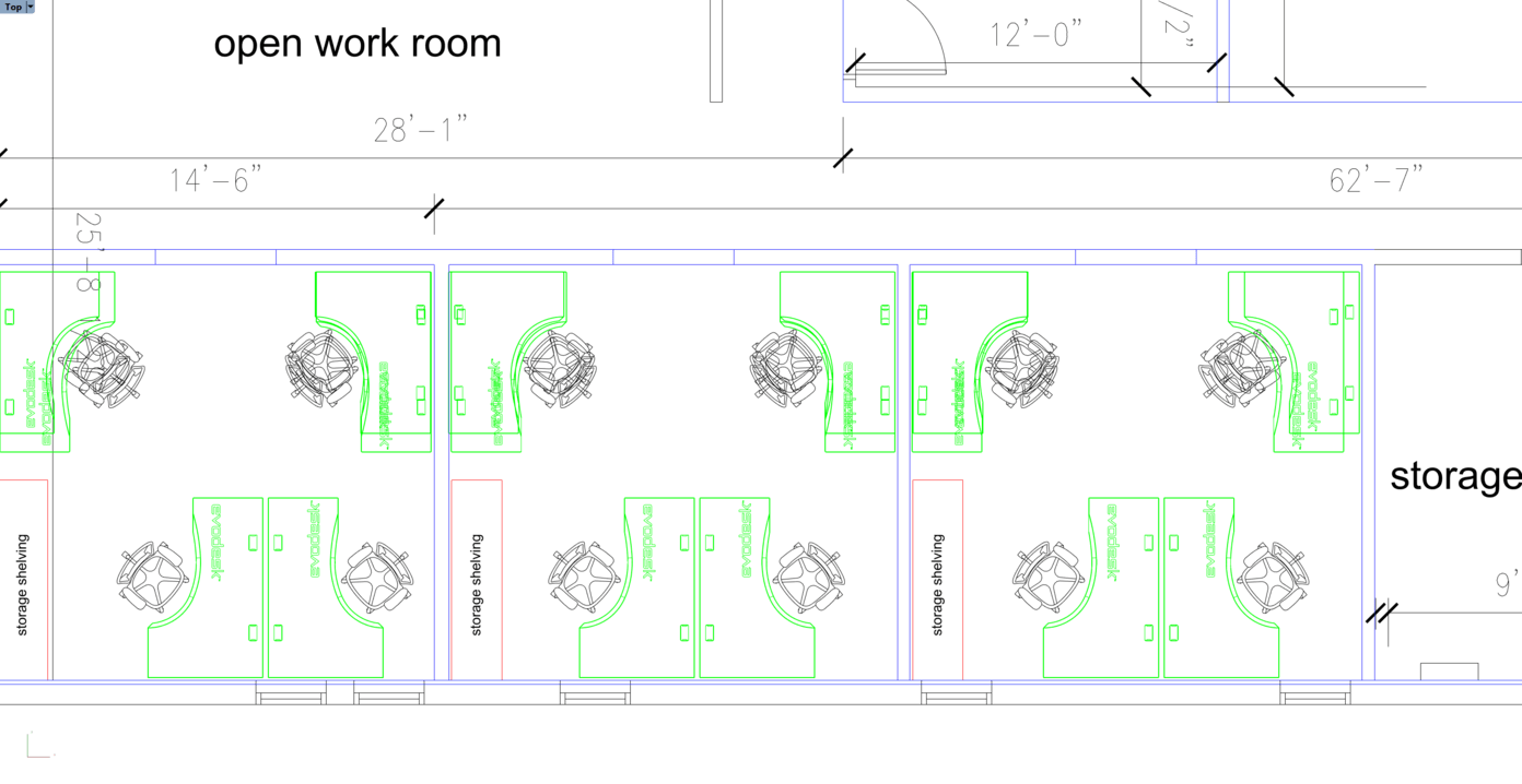

…speaking of moving things around with keyboard and pickable input… I today was layout out plans for a new studio, non-critical work, but after doing a bunch stuff I realized that some of my desks where scaled 1D smaller in one direction. Why? because while I was moving things around I must have accidentally clicked the scale handle:
