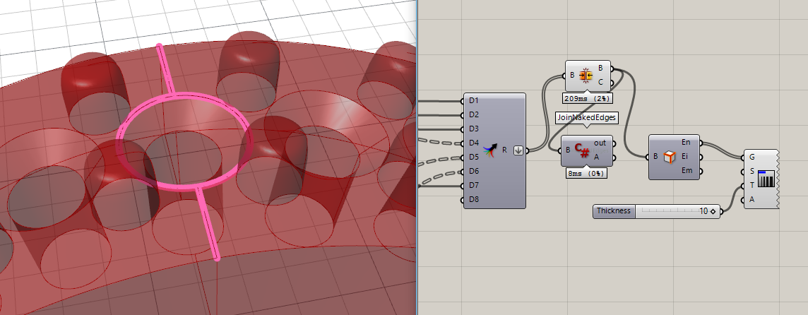

This trimmed surface comes from flow a planar surface to a ring shape, is a part of my model and I need to join those edges together in order to get a closed brep with the other parts.
The meeting edges are not joined, so they are duplicated, and I have not found a way to join them, getting two internal edges instead of four naked edges.
The Rhino _JoinEdges method works, but I must do it from GH. I tried Brep.JoinNakedEdges() but it doesn’t work.
Any suggestions?

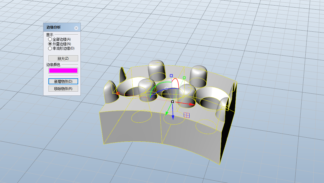

Hi Dani
You can solve your problem,like this.
1: Explode a brep
2:join a surface
brp_new.3dm (486.0 KB)
I hope this help you.
Like Dani wrote, it’s no problem to fix this in Rhino, it’s a GH thing.
As such, @Dani_Abalde, it would probably be more helpful to post the GH file instead of the Rhino files.

I needed to create that ring shape without Boolean operations to make it as fast as possible and I just found a method to build it faster and without this problem, so, it’s solved. Thanks for the advice!
Hey Dani,
Not sure if this is helpful but R6 rhinocommon has this method Brep.JoinEdges(); Which seems to have more control specifically over tolerance settings. Seems you solved already in another way but maybe useful to know for a future situation.
