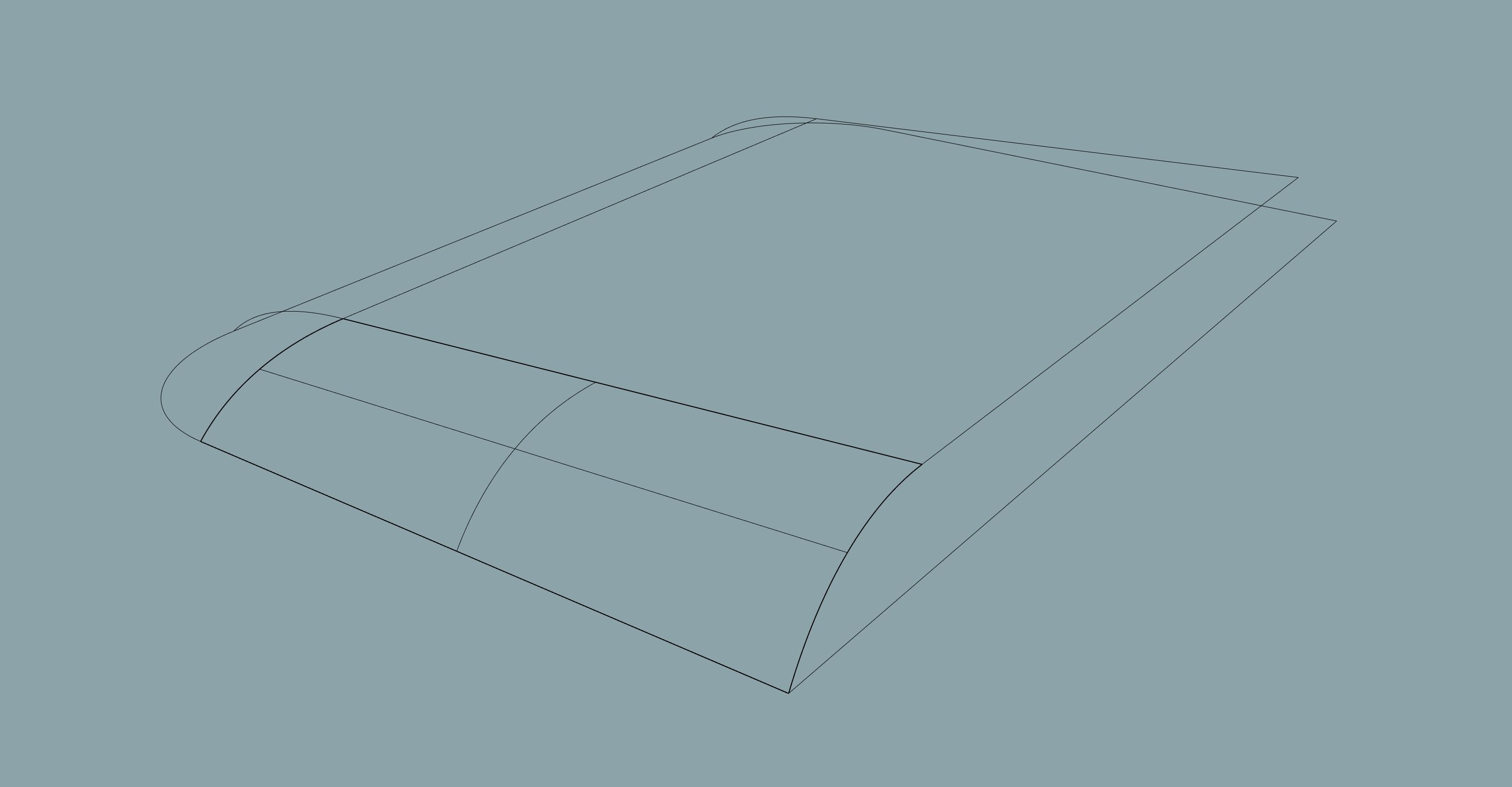

I have been experiencing some strange jagged appearance when constructing a 4-sided surface.
I have tried to modify the mesh settings, but it doesn’t improve.
However, in the surface analysis (env. map) it shows as a clean and smooth surface.
It just started happening recently. Anybody know’s what is going on?

I have tried various mesh settings, as I already indicated. Thing is, I have been using Rhino for many years and this is happening more and more recently when creating surfaces, I found.
I’m working on Windows, but colleague of mine who is working on Mac experiences the exact same problem.
Please find the test-file below.
jagged_surface.3dm (148.8 KB)

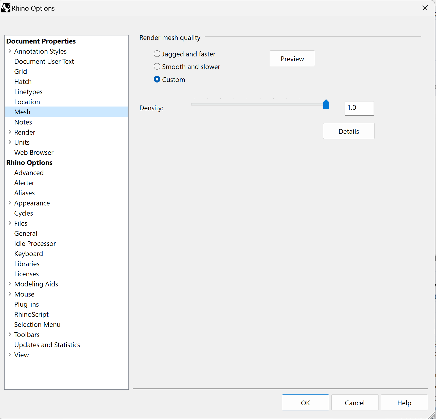

Try moving the “Density” setting from 0.0 to 1.0. The render mesh with 0.0 is very coarse.

@JimCarruthers I think there is some self shading issues caused by the fact that the posted surface is a bit twisted, and with the original mesh setting this results in triangles with awkward aspect ratio.
@shakedesign In addition to the proposed change in density, set aspect ratio to something between 4 and 10, that should help with surfaces like these to avoid this issue.

.@Gijs Where do youset the aspect ratio to 4 -10? I can set the render mesh quality (simple) to 1.0 and then the artefacts also diasappear, but I guess that’s not what you mean…?
But as said, this never happend before.
Click on details in that window and you get more meshing options.

Usually I work with the following settings that give the overall best results:
I keep all parameters set to ‘0’, except the ‘Max distance, edge to surface’.
But now these setting give triangular artefacts as well for the ‘Smooth & Slower’ preset.
